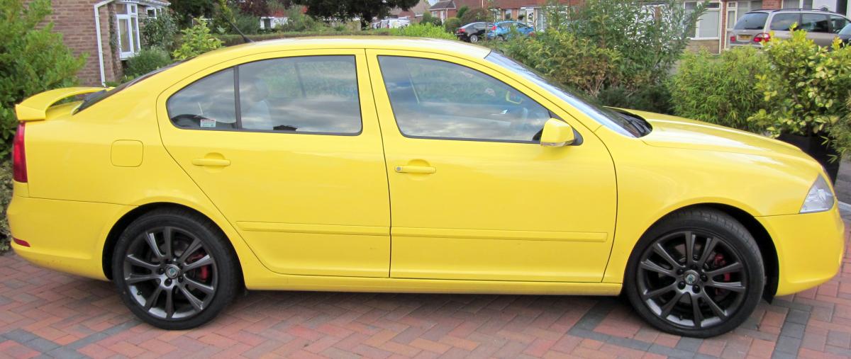

Nice look, I think!!
Running at 32 psi all round, and will now be checking at least once a week!!
Hmm. I'll try attaching that picture again, on my laptop rather than my mobile!!
