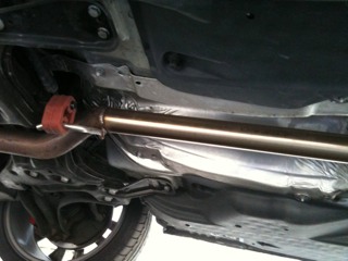

Remove middle silencer. A few have done it on here, sounds good and only cost about £70-£100
A lenght of pipe costs £70-£100???
Mine was removed for £60, top job!
Sounds lovely on start up

Silincer removed :)
Where have people been getting there centre silencer removed at?
Mine with the centre silencer removed :
Edited by VRS-Powered
£60 from local Powerflow dealer :)

Modifications will only invalidate the parts they replace and work with. The centre silencer being removed will only affect the centre section of the exhaust, Skoda could argue about the whole exhaust but they would have to prove it.
Yeah I'll be up for the tunnel shoot :)

Wicked stuff. I never used it as mine was pre reg. I'll try get me mate with a green one to come along. Only be a yellow one missing then. Anyway back on topic. Just take out the centre silencer and stick an induction kit on and it will sound ok
Silencer I can do myself as I am not very keen on paying £60 for undoing 4 bolts and welding in a £2length of pipe in its place... In any case I would like to have a system where I can revert to stock so no welding to the stoc exhaust. Steel pipes are rather affordable...
Induction kit cost ridiculous amount of money! ITG Maxogen sets you back in a region of £500! that is for an air filer costing max £50 from K&N, piece of shaped plastic (looking like carbon fibre) plus jubilee clips and some large diameter o-rings and a lenght of flexible air pipe for £10...
