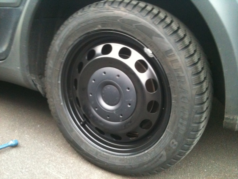

I went for slightly different approach for centre caps, but still from VW and think they were also from a Caddy. Don't get confused with the ones with a big 'VW' embossed as they are from a T5 and they don't fit (wrong PCD of 120mm) but go for the ones with 'VOLKSWAGEN' written in smaller letters as they are the correct 112mm PCD.
You can see they cover the wheel bolts and make naff looking winter wheels look less .... naff!
Think they were about a tenner each which is a lot for a bit of dark grey plastic but they do work and keep the muck off.</p>
