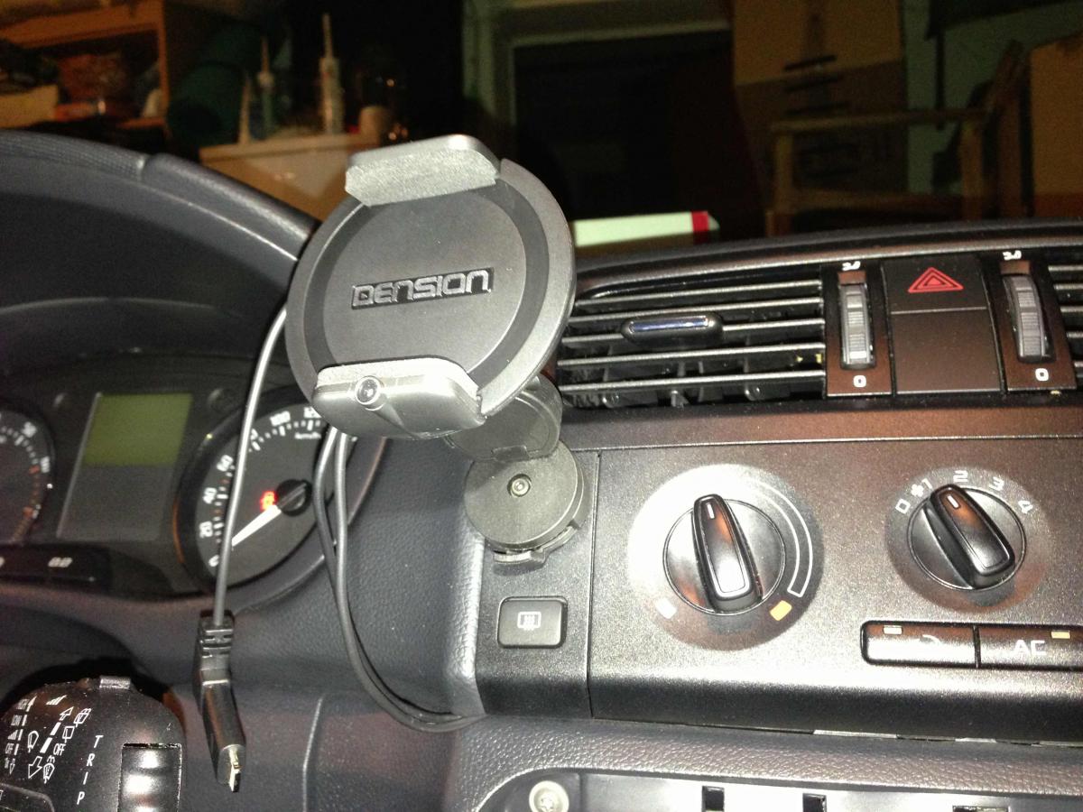

I've managed to do the poor man's version of the 12V tapping. Here's a short picture report:
Here's my Dension BT handsfree device. Charging and line-out wires go hidden, behind the dash:

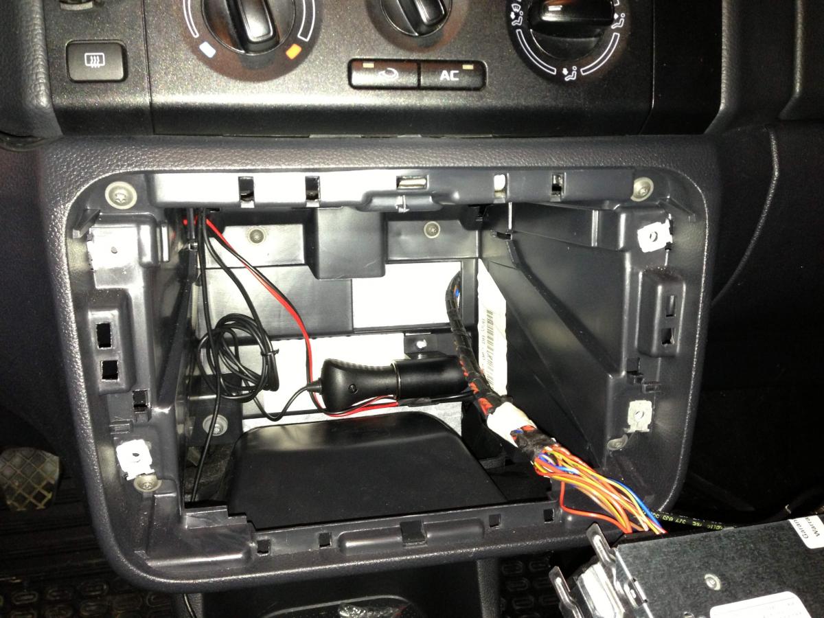

I pulled the wire to the radio compartement, and installed a cig. lighter socket at the very bottom using my swithed power. All that was left to do is connect the (cig. lighter) power of the BT device.
And tadaa, here I have an ignition swithed BT handsfree in my Fabia :)
