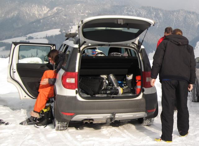

This is how the original exhaust pipe trim looks (made of simple galvanised metal sheet)
Petrol - single pipe
Diesel - twin pipe

Thank you Rafi_arch for the photo, much appreciated, and everyone else who has replied. It looks as if the twin pipe system is not for the 1.2 model, but in saying that the single bore looks sporty enough

See #3 post above (thumbnail photo) - only 1 pipe (1.2 TSi). Must be that Euro spec petrol Yetis have twin pipes.

Yes,the first 1.2 tsi Yetis had twin tail pipes than after aprox' 12 months changed to the single pipe.
