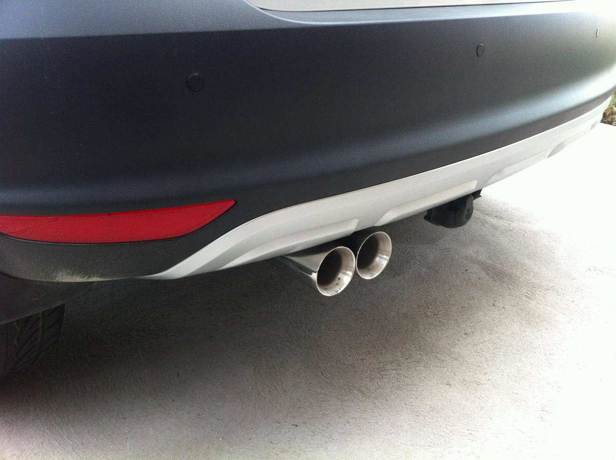

post-100987-0-79585100-1371294150_thumb.jpgI popped these onto my Yeti last week - and by 'popped' I mean:
- Tried to fit trims without cutting pipes - IMHO looked horrible....so...
- Removed bumper trim (easy, 3 x centre clips, 2 x hex screws)
- Marked up twin pipes at same angle as the trim pieces.....wondered if pipes were stainless.
- Started sawing (after masking saw ends to prevent scratching), found it is bl**dy stainless
- Sawed....and sawed....and sawed,,,,,hacksaw broke
- Fetched Dremmel with TC cutting bit (I use this to cut stainless ramps for pinball) broke two blades
- Temper now more frayed than exhust pipe
- Round to mates to borrow angle grinder
- Safety glasses on
- lobbed off pipes - 10 minutes flat
- Hammered on trims with wood block
- Snagged out the job with some fiddling to get them 'right'
Learnings:
- Happy I did this as the pipes look great (even 'she who must be obeyed' likes them)
- It's not a job to be taken on without a grinder
- You definately need to do this in a well ventilated area and mask off everything as the stainless sparks are hot and fly everywhere (including my eye despite the goggles)
- The twin exhasts are a swine to cut if you are as picky as I am and want to keep the minor length difference
- Despite the instructions don't cut them 'flat' they fit better with a slight angle
Here's a pictures, I've also now recoded the software, fitted the boot protector trim (using Tiger Grip), the door trim foot guards, a brighter boot light, the bonnet sound absorber and the next project's going to be a rear view parking camera.
Edited by DrPinball

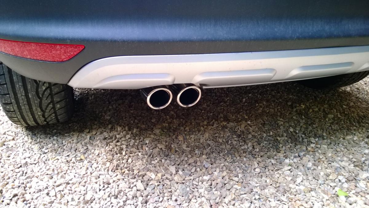

On 24/10/2012 at 19:14, Truthseeker said:
Did not know that - cheers. I thought my pipes looked brighter than mild steel.
I do hope they are stainless [origanal tail piece] I am pretty sure they are a magnet does stick but not as strongly as on mild steel.
I dont want to be messing about fitting a tail pipe although they do look nice, so I am polishing the standard one early days as I am starting on 400 grit wet and dry.
Will move up to 600,1000,1500, 2000 and 2500 not sure if the 3000 will be needed.
Polish with autosoll and maybe a light buff with some baby oil  Hmmm will it work we will see,its a job In progress and not rushing if It works i will post a pic.
yes it does work!
Glad my car came fitted with them!
