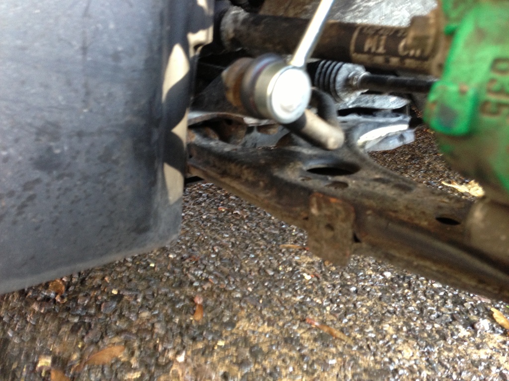

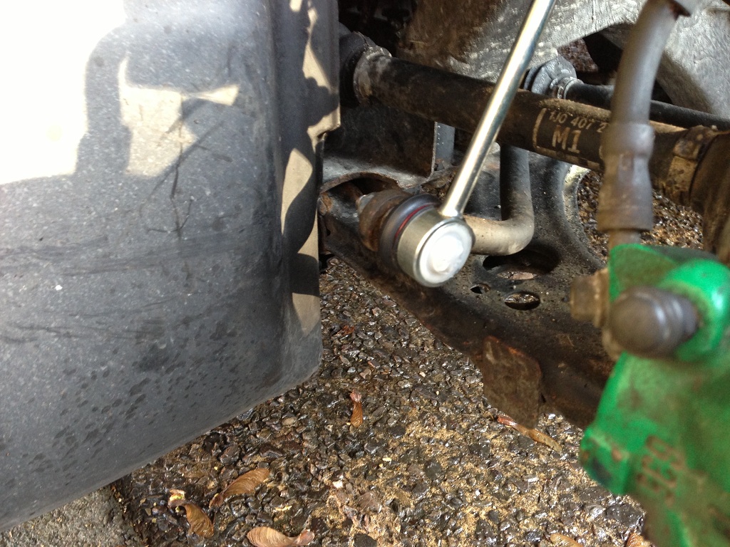

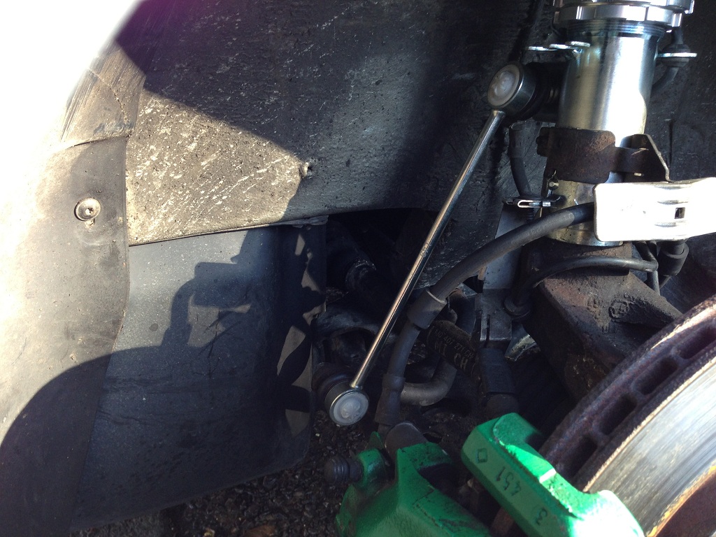

A couple of pics I took this morning.
Sorry I couldn't be arsed to take some propper pics as it was too damn cold to be messing about with cars. I just wanted to raise the front a little and get back in the warm lol.
Anyway here are the crap pics I did take.
looks like it did the trick buddy
Yeh seems to work
