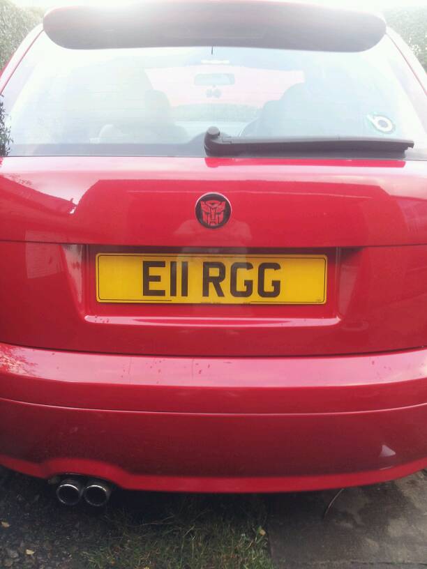

As the title states really, i wanna change the rear badge but i dunno how to get to it, advice please! :)

Already done it now mate, had to saw a bit off to get it back on but it aint noticeable, and yeah i coulda left it on haha :( pic of end result:
