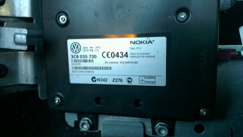

Thanks - just checked under the seat and we currently have 3C8 035 720 - so just need the 'A' wiring kit as per the eBay item number I quoted earlier and we are set for the phone to match with hfp mode ..... yes? Sorry for all the questions, just don't want to get it wrong!
andy what does your box have as the last letter after the numbers
bill
Hi Bill - picture of the box attached - no letter as far as I can see.
Ah, just realised I put a type in my earlier post - unit model number is 3C8 035 730, not 720.
I suspect yrs is an A revision and that's why there is no letter. Maybe they didn't expect a 'b' or 'c' at the time of manufacture!! I think the c units in that series gives hfP functionality. And not sure where you are but if its anywhere near me, Newport, South Wales, you are welcome to try mine as a test. Mine is a d revision of the 5k0 035 730 series, which also works with hfp.
