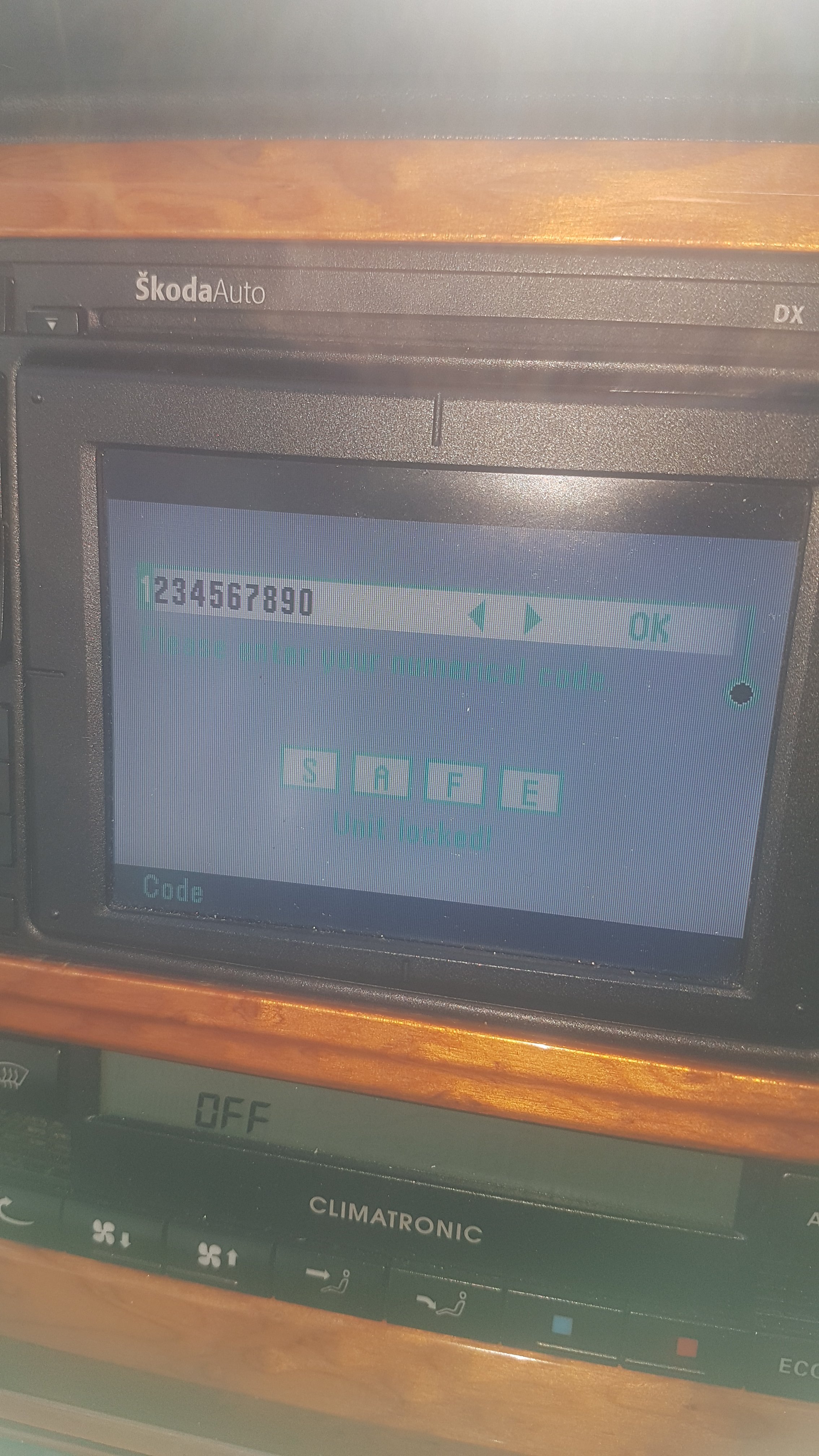

My radio is on safe mode
You need the code, or a trip to the supplying dealer, or a specialist who. can remove the code.
Is on safe mode
Unit locked
Do you have the code?  SAFE mode often comes on after entering the code wrong too many times.  You need to leave the keys in the ignition with the unit displaying safe mode until it lets you have another go at entering the code.  But you need to have the code!  Do you have it?
Yes  i have  code
Just put the code in then!  If you entered the code incorrectly many times you will have to leave the car on with keys in it for a while until safe mode passes.  It does this to prevent "brute force" attack of trying out every single code.
