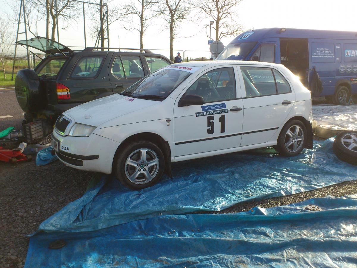

Lol passed scrutinerring all ol just keeping an eye on the weather tonite, first stage for us is 10:25 so hopefully I wont be posting here before tea time
Why the front and rear have very different heights?
Just how it's parked mate I'll get a better pic in a bit
Well it's still straight anyway ;-) all good so far everything working well too. We changed the rear springs for std ones as it was a bit twitchy . Just been building confidance in it so far and trying to keep out of trouble on very slippery greasy roads
In service before 1st stage, after today's 6 stages we are 55th overall which I an happy with and now I have some confidence in the car we will push harder tomorrow and try to make a bit of time up. There are over 15 retirements already so we are doing well to be running still with the only problem being the power steering fluid boiling by the end of the stage every time meaning tight chicanes are done with no assistance lol
Still higher from the front :p

I am using an engine mounted power steering pump instead of the fabia electric one, and it seems that there is a mismatch in flow rates causing the fluid to get hotter and with the short pipe runs I have back to the resiviour it doesn't give the fluid chance to cool before entering the pump again, it was actually bubbling after the 5.5 mile stage and I had no assistance below 5000 rpms which was a bit of a problem in the slow tight parts lol.DSC_0487.jpg
The rear was sat about right with the octavia springs on but too stiff for the very slippery roads and after a couple of high speed "twitches" we decided it would be safer on softer springs, front is a bit too high really and too soft on 225 lb springs for tarmac but I didn't have time to fit the tender springs so we could drop it more.
we have done 55 competitive miles with it now and the only spanners we needed were for the spring change so I am happy with that and we didn't have the tyres that would have made the difference on the cold roads.
The biggest improvement will be a plate diff and some better gear ratios but it will have to wait for a bit while I save up first.
