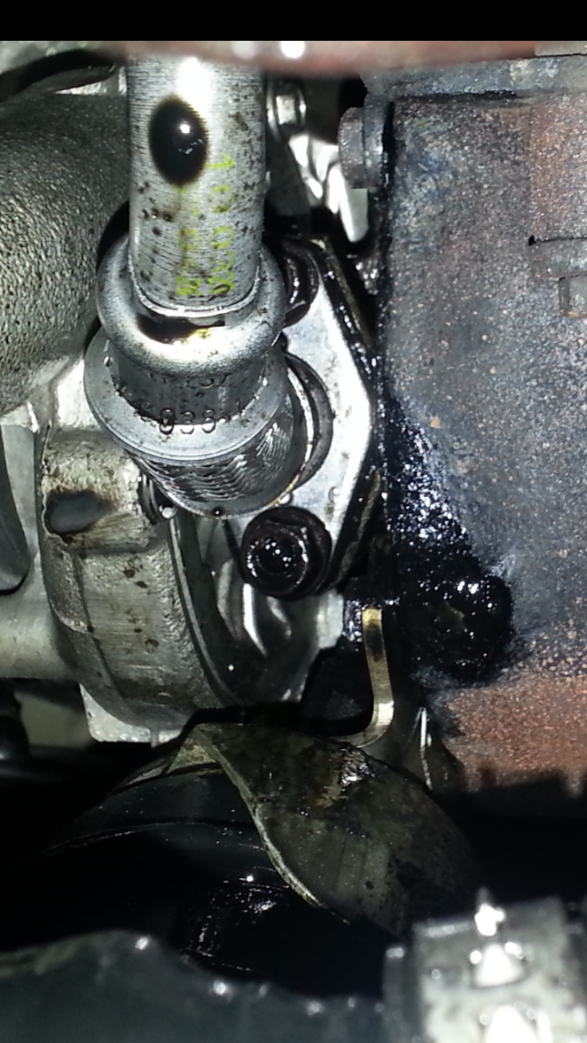

oil leakin from turbo,does this mean i shood look at replacing?
basically oil appears to be leaking from turbo,covered the rack in ****ty oil to! also removed intake hoses (the elbow by the egr and the long black one connected to it) and theres oil there to! shood i b trying to get a turbo asap or shood i not be to worried yet? havent seen a loss of oil on dipstick tho

Are you sure it's the turbo, and not the EGR that's leaking?

i had a weeping egr valve which i found oil in my pipework right down to the intercooler and loads of thick oily carbon in my egr, i have given it a good clean and to date now have very little if not any oil weeping from the egr valve as for the turbo cant say as i havent looked around that area (think i should now). is the turbo making a whining sound or sounds different. hope this helps, have a check of your egr valve use a torch and check inside.
jus one picture,there was oil all over the inside of egr,pulled the hose off and hola oil,also leakin outa the tiny hole on the side of the egr,been readin up on other peoples failures but mine hasnt gone yet! no smoke either btw
Between that pipe and the turbo is a tiny gasket by the looks off the oil id say the gasket has gone failing that try cleanin it all off and running the car to see if you can see it leaking from there
That's the oil feed pipe isn't it? Could be worth replacing.
i guess the best bet now is to remove pipes and see how the shaft is?? if the shaft is happy then im all clear rite? jus gta replace the oil feed pipe and gasket

The the oil return pipe, and as said has a gasket in there so might just be that that needs replacing (and a good degrease!)
While you are there pull off the inlet pipe (metal one from air box with rubber connection to turbo) and have a look inside and see how much play there is. To be honest, it just looks like fresh oil, which points to the gasket on the oil return if its running ok.

Another thing while you are there is to check is the oil feed, which is on the other side of the CHRA (the top facing upwards) to see if thats ok and not leaking and dripping round to the bottom where the picture is looking at.
best just clean everything then take another look after a short run or run it on ramps if you have them then decide simplest things first cheeper that way
