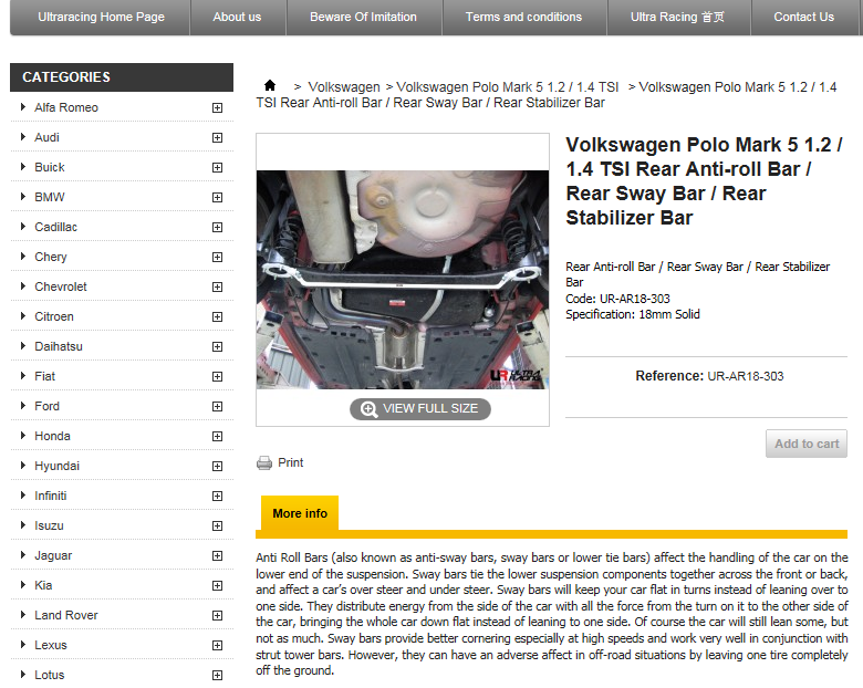

I'm in Thailand and there's not many fabia here,
there is this ultra racing bar and it's only 18 mm, is there anyone using this bar?
I can see that the size is the smallest one among the bars you are talkning about but it may be the only one available here, please give your opinions about this bar. thank you..
p.s. I was going for VWR springs but the price is 4times more expensive than the price in UK wow so I have ordered Eibach springs instead, waiting time is 1 month and the price is 50% more expensive than UK but pricewise it's far better than the VWR.
