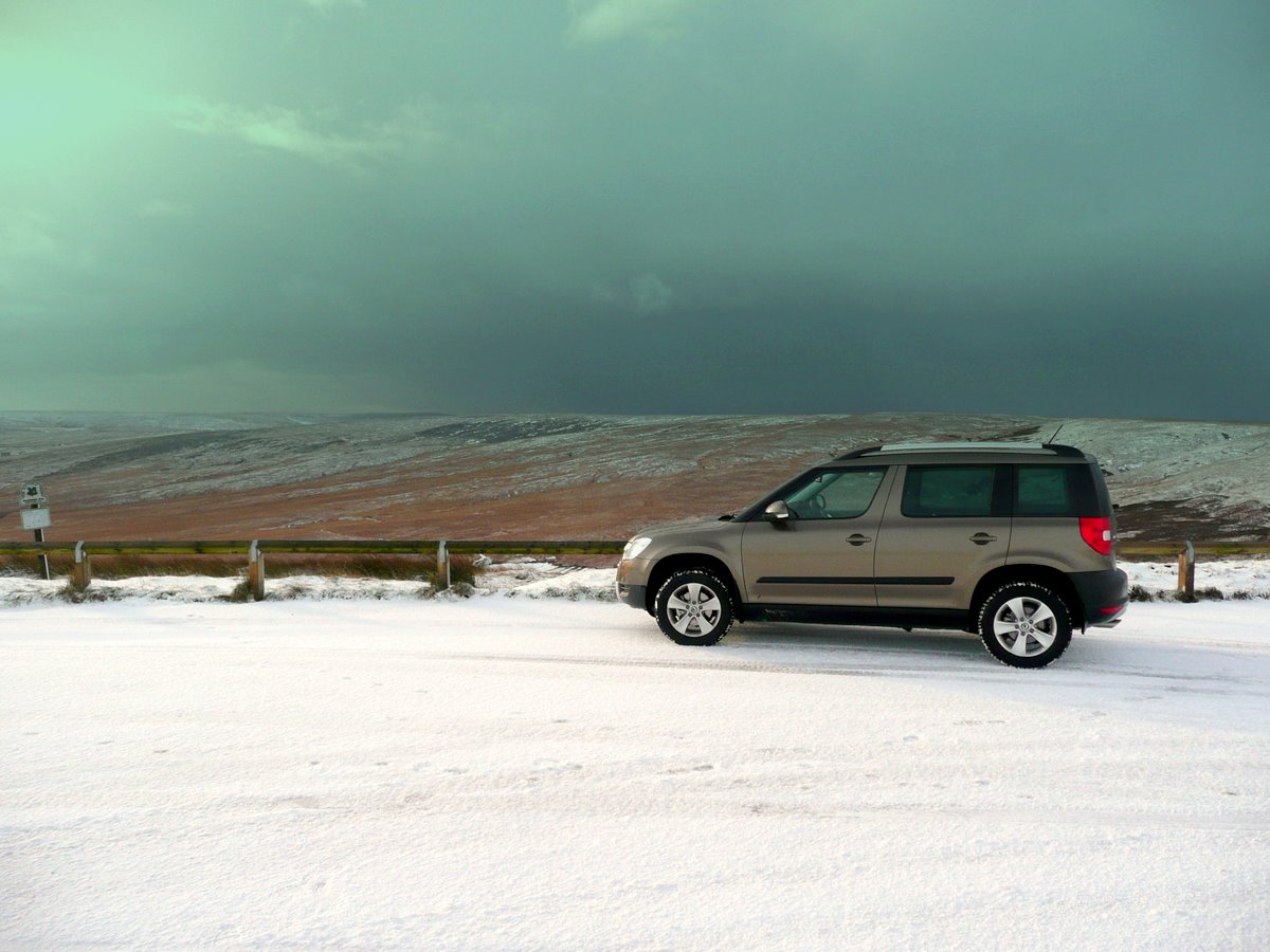

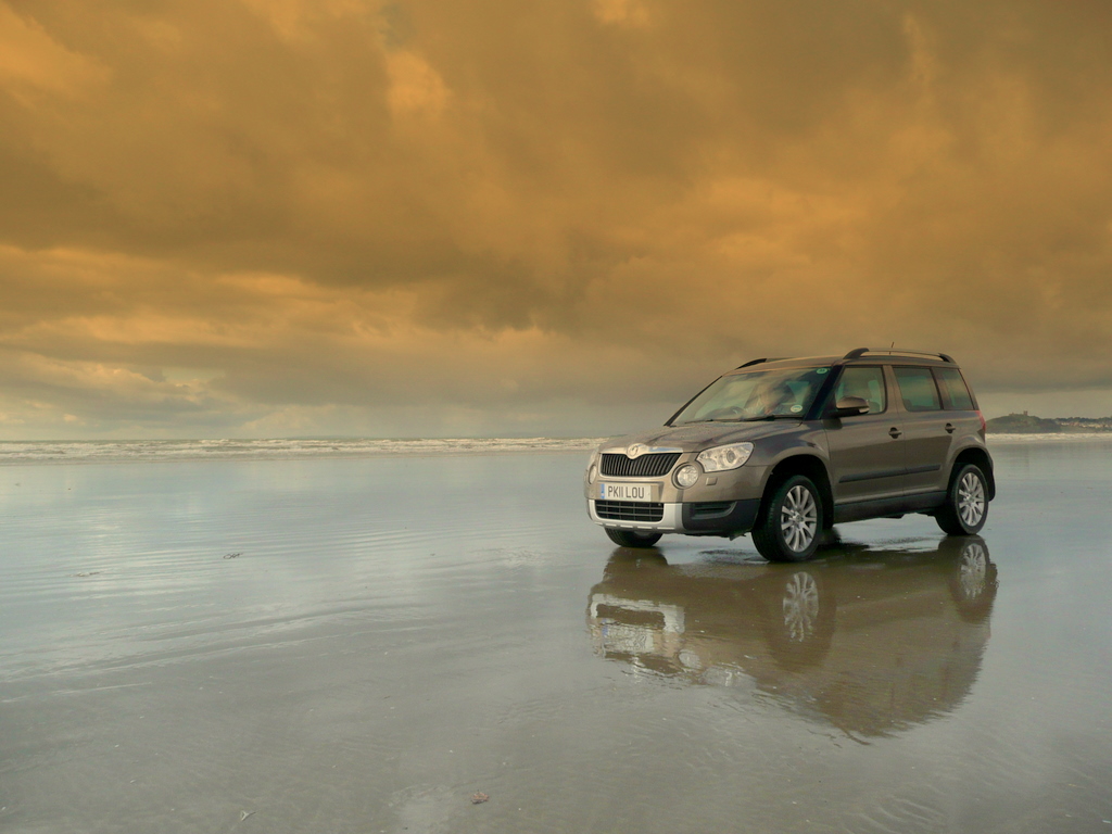

16" Moons + Winters on now and 17"Annapurnas on summers. I think both look great.
A much softer ride over pot holes and speed bumps on winters but handling/grip on summer Pirellis is great if bumpy on uneven surfaces.
Think I perhaps am fortunate to have the best for both seasons as long as we don`t get any late spring or autumn snow.

Nice pics Peter!
Yes! The second is Black Rock Sands with Criccieth Castle in the background. Was there birding yesterday; very low tide.
Isn't it a bit cold for that kind of thing?
Very!
