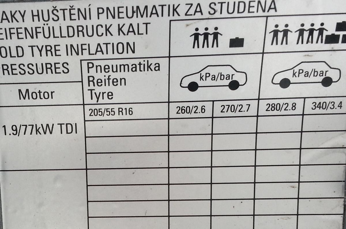

Is it tyre pressure 2.8 Bar normal or 3 bar ? any experience :think:
My car recommended loaded pressure from 2.8 to 3.4 bar ?
Winter time I need to add 0.2 bar by the booklet at the momen my tyres pressure 2.6-2.7 Bar
Adding 0.2 bar Im reaching 3 bar tyre pressure
My tyre Max Load 670 Kg at 340 Psa or 3.4 Bar So in theory I can inflate up to 3.4 bar? This what written on the tyre.
Is it not risky to drive 3 bar tyre pressure? :think:
Please see attached file:
Regards
Inco

Why do you think its risky it is whay is recomended and below the limits.
