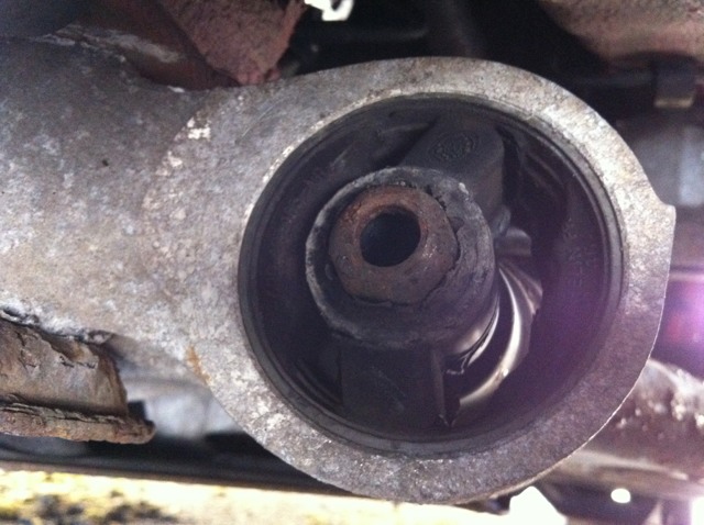

Console bushes: Knocking when turning/cornering, put car on full right lock then check the left side, the old bush was vertical only, new ones are x shaped. if it looks like the photo below it needs replacing. Cheap parts but not that straight forward, if going DIY then Powerflex is the best option but more expensive.

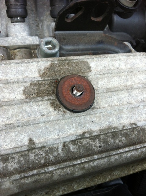

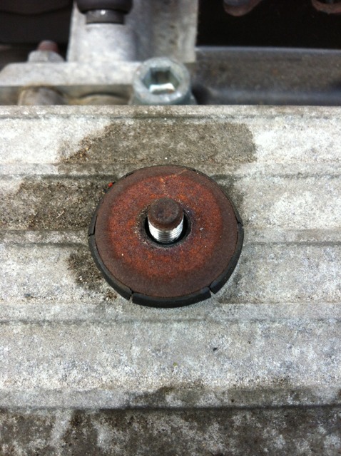

Rocker cover: Seal fails as do the nuts/washer, weeps oil which travels down to the block and settles at the HG which looks bad. Very easy to fix and under £4. Take the engine cover off to check this.

Console bush with tear showing: post-52723-13608830747607_thumb.jpg
Rocker cover with weeping oil:
