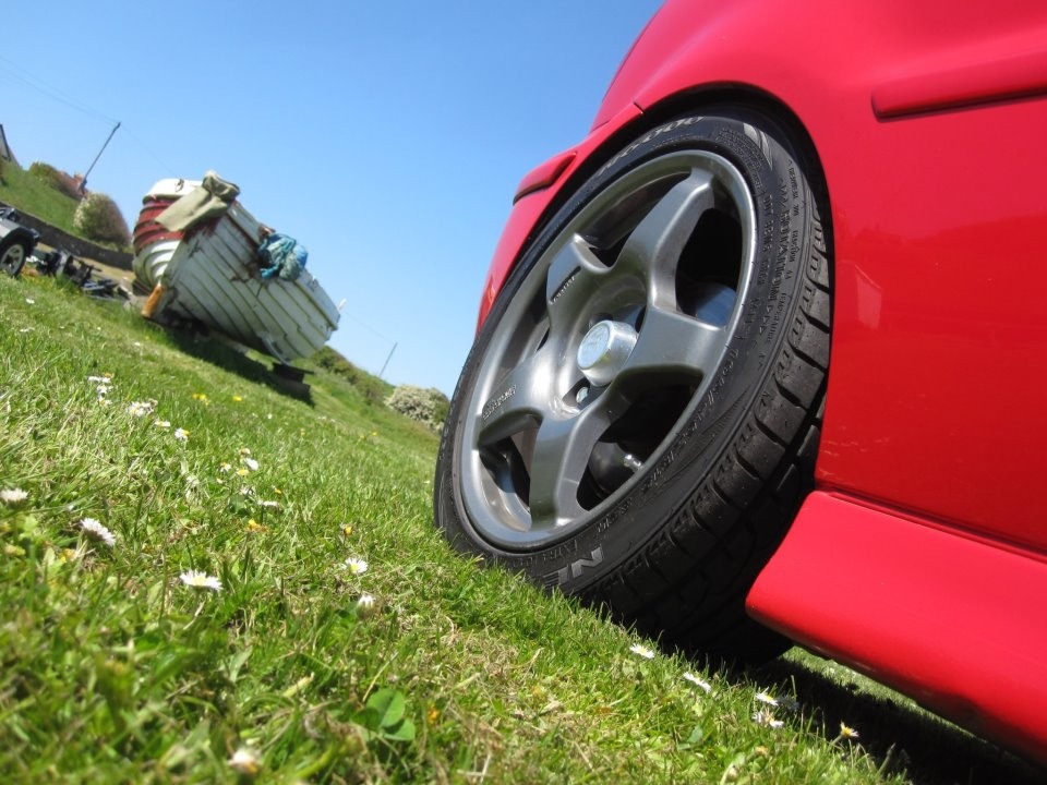

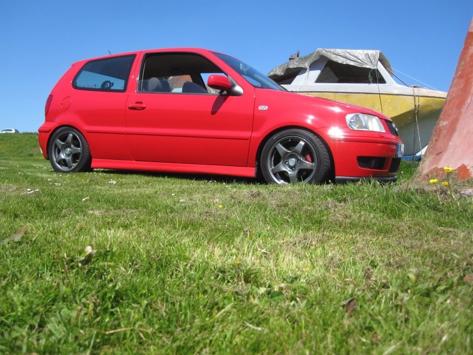

I had a set of these in 15s on my polo gti 6n2. This is the Compromtive Mo5 gun metal colour. I think it's a mint colour. You can get the colour from Compromtive.post-99607-1360873417202_thumb.jpgpost-99607-13608734367126_thumb.jpg
