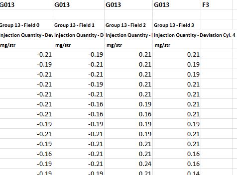

I have a strange issue where when the car is first started it is as rough as rats, almost like its missfiring.
It stumbles, rocks the engine and will not idle smooth until warm. Oddly though power is good when cold, so suggests the injectors are able to dump fuel in ok.
Solutions thus far:
I've had a good lot checked (EGR - cleaned replaced, Glowplugs - Brand new, Injector and glowplug loom - Brand new, fuel and water temp sensors - new, etc) yet nothing has touched the issue. Tried new fuel filter and run copious amounts of injector cleaner through it.
In VCDS, if I drop the idle revs to around 700 when cold it practically stalls out. It's that rough!
When fully up to temp things are fine and its pretty smooth (for a 2.0 PD ;)). Power is good. MPG easily 50+ mpg.
As per the VCDS print out so you think it could be injector 4 thats shot...or going that way? Worth cleaning the injectors or is it time to bite the bullet and replace it?

3 & 4 look odd when cold.
