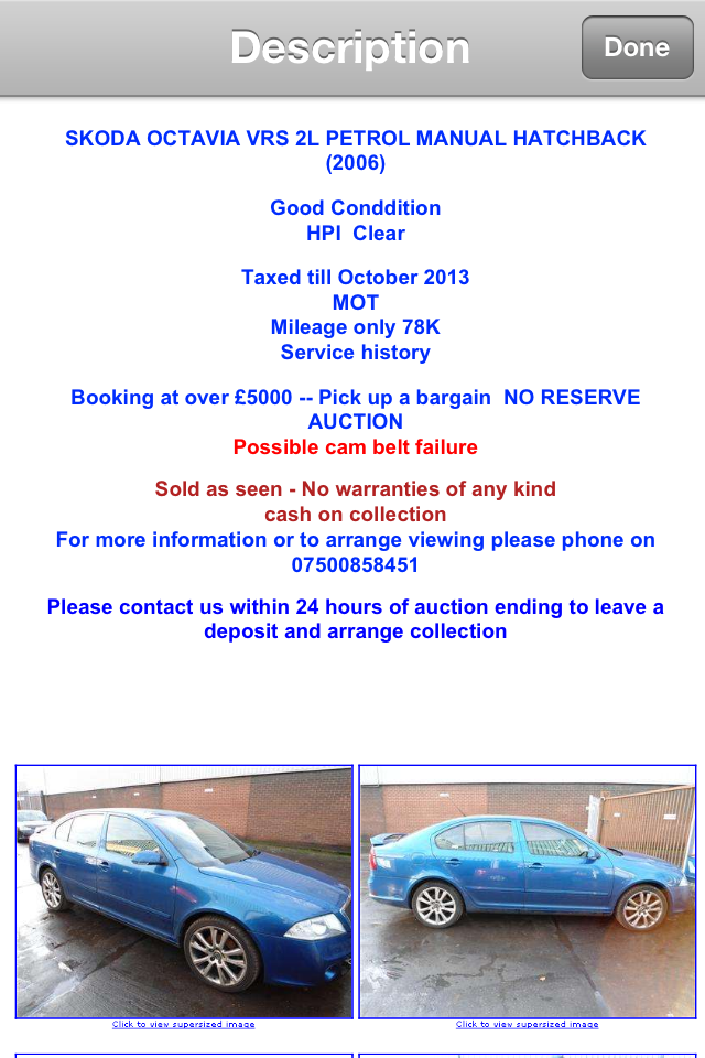

So... Was having a casual snoop on eBay as I wanted to get another vRS after missing my MK1 Fabia... Thanks to the loins' productivity we are now a +1 couple. An Octavia was the only genuine option. I am immensely tight and half capable on the spanners so I wanted a broken one! Annnd 1 night I found one [emoji106]

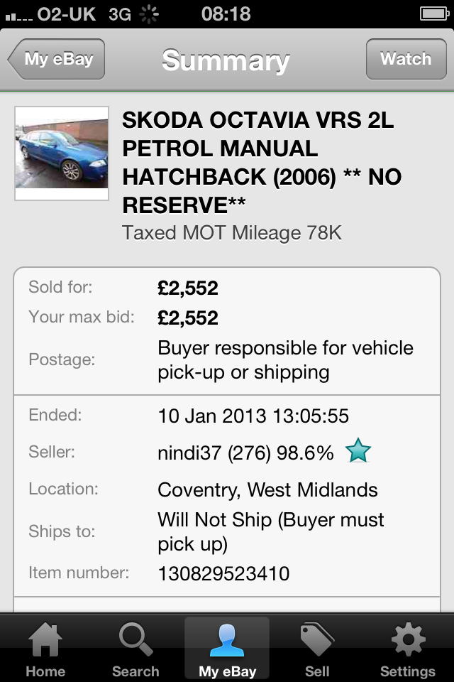

After 7 days of watching my eBay account I won.
Got the car home on a trailer and the morning after I got some pics...
