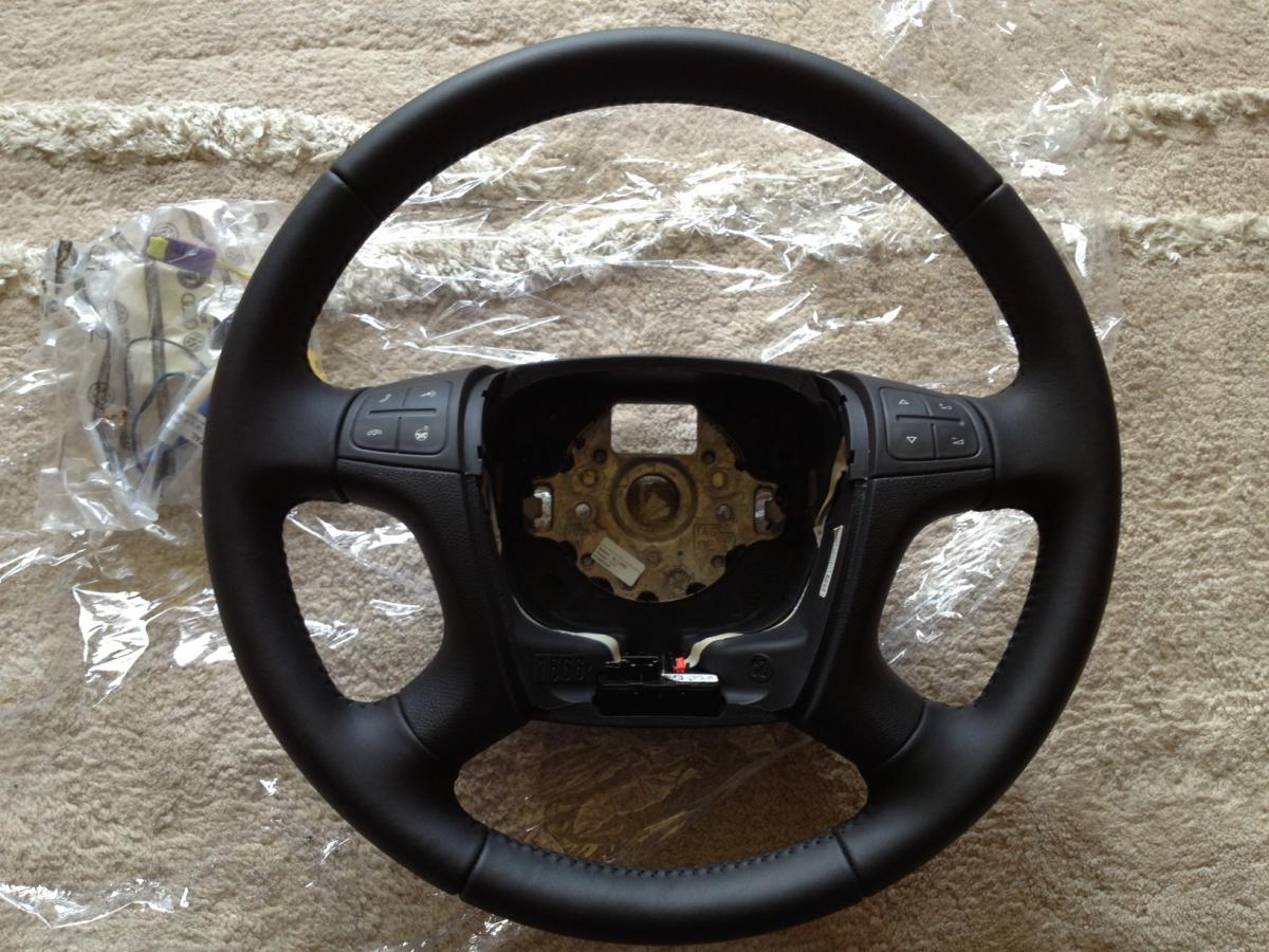

And brand new pre-FL leather MFSW awaiting fitting using old airbag:
Although I'm not 100% convinced the leather is of exceptionally high quality, but it is a lot better than the current plastic one that is falling apart.
