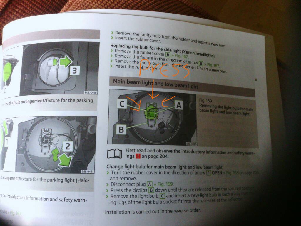

Hi Jez, for those of us lucky enought to have never replaced headlight bulbs in over 40 years of driving, will you be a little more explainatory about the method used to remove the existing bulbs and fix the new ones in place. I have already removed the round screw on cover and had a look, but do I just push hard on the end of the hairpin retaining spring or pull outwards on it.
Cheers, Banjo
Cheers, Banjo
Aha OK, no problem. You need to press the protruding part of the clip till it un-clips. The bulb is held at the top by this clip. Pressing the clip means it pivots upwards and releases the bulb. As a note to this I found pressing clip nearest the end gives the best leverage.
See below hope it helps:
The arrow where i mark press is where the protruding part of the clip is. The the other arrows is where the clip retains the bulb. I'm afraid to say you have to apply quite some pressure to get the clip, unclipped.
Oh yes on the nearside note you are best to mount the bulb looking through the light lense....
Best of luck
JeZ
