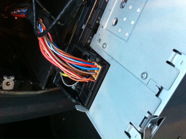

I noticed in your post you had a 'how to' picture sent you. Do you still have this at all?

its on the middle of the loom that you got in the kit
The two white plugs seen here ^^ try swapping them around
I'm assuming this little white plugs are normally hidden within the fabric around the loom & I need to take the fabric off? Sorry for the stupid question but thanks for bearing with me on this one.
Mine wasnt covered over with fabric but the wiring going to it was and i had to cut some of the fabric tape back a little to get movement in the plugs, be ULTRA careful take your time there is no rush to do it.
Grizzle is correct, I did the same. Wired it the wrong way around first time and got the issues you had.
Again not sure on the Bluetooth streaming front, mine is very loud on this as long as the phone volume on music is up high.
If it is a similar loom to the one I had and it seems those above, there are two ways that you can wire the mic hence the white plug / socket sets.
The mic cable comes down and it presented on a plug (or socket can't remember which way round now), if you have a Columbus this needs to be plugged into the connector that goes towards the head unit, then the other two plugged together, if you do not have a Columbus it plugs into the connector that goes to the quad lock socket that the existing car loom plugs into.
The connectors are there so that with a Columbus you can send the mic via the Sat Nav, in the case of a Bolero it needs to go straight to the bluetooth module.
