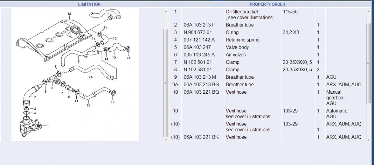

You want parts 2,3,4.5.6.10 and some jubilee clips to replace the single stuff that will be on there. that lot should come in at around £40 IIRC

I already have a silicone Crankcase breather hose (Y pipe) and i have found a Silicone Lower breather Pipe, but I cant find an upgraded parts for number 2,3,4,6 and 10, are there such upgrades or would it just be a case of using standard parts for these parts ?

no worries mate, I'm still trying to find a part number for the actual standard lower breather pipe as the one up there ^^ has an additional pipe coming off it,
Sorry just checked again its 9A you want for the auq not number 9 which is for the AGU block

according to Skoda (I just called them) I need 9A which is £37 and 13 which was £15 or similar, but again my pipe is one piece, Im pretty sure this is the right pipe http://www.ebay.co.uk/itm/Engine-Breather-Hose-for-VW-Mk4-Golf-Turbo-Audi-A3-TT-1-8T-Equiv-06A103213AF-/150991601816?pt=UK_CarsParts_Vehicles_CarParts_SM&hash=item2327cd0098 would be great if anyone could clarify this part for me..
