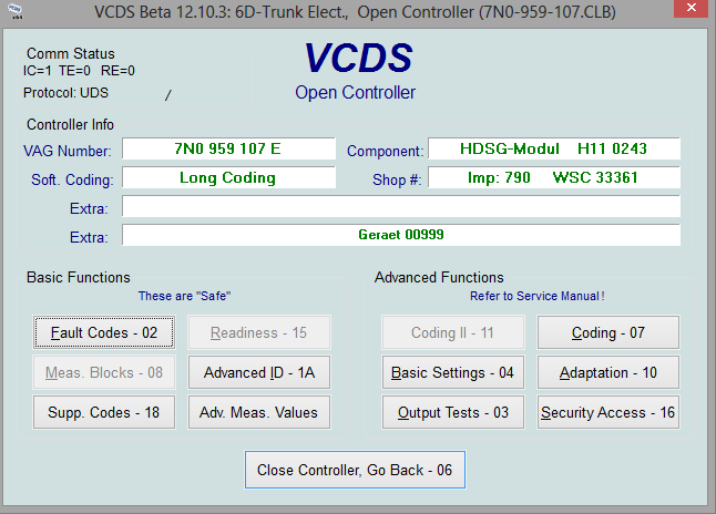

I just came across this - I’m guessing this can’t be done on the S3?
Depends on the age, 2015 and very early 2016 cars can be done (via VCP)

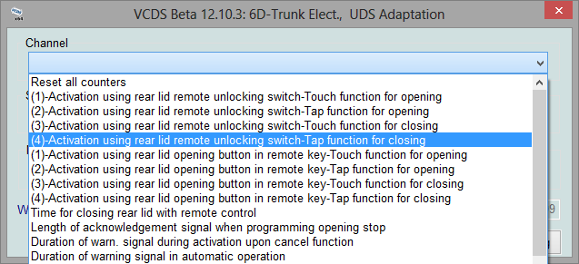

Yep I know but this topic is on about using VCDS to do it - assume it’s S2 only?
Correct, VCDS cannot do the MK3 Superb
Hello all :)

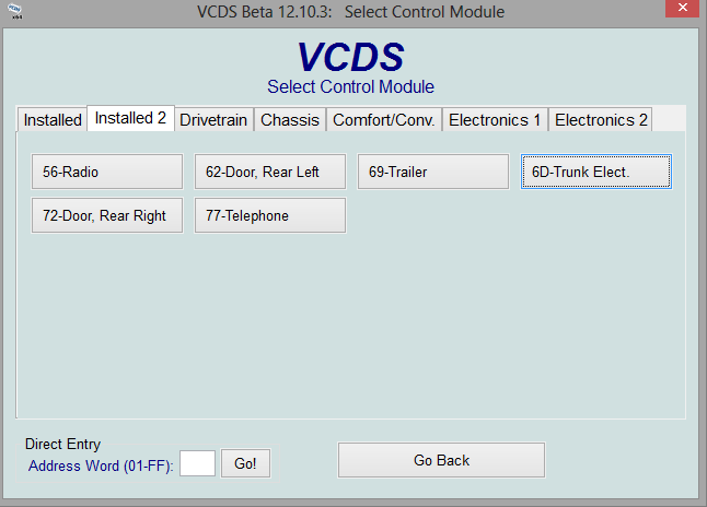

I would like to do this on my Superb 2011, using VCP.
Unfortunately, I am not successfull,

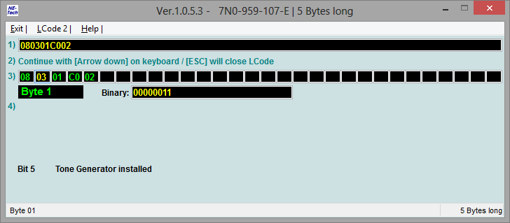

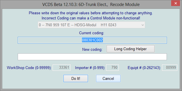

I can find the 6D and code it, but in VCP I cannot find the bit for closing the trunk using the button, all other explanations are for VCDS, which is not VCP.

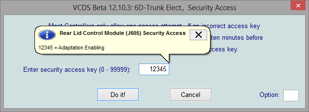

Additionally, I cannot log in with VCP using 12345.
Could someone help me coding it with VCP?
Does anybody know the correct bits for that, as VCDS only lists channels, but not bits?
