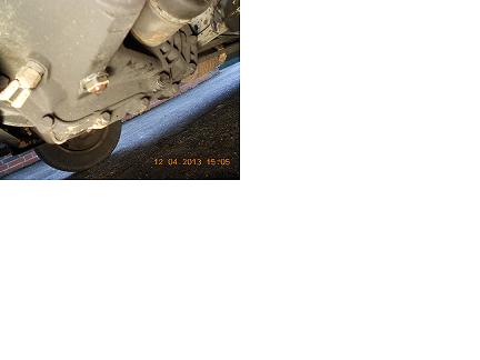

My Fav has started to leak gear oil. Crawled under expecting to find drive shaft seals leaking but no.
It really looks as though the drain plug itself is leaking. Not from its washer but through the plug itself, which seems to have some sort of central core. Is this standard? or is it some sort of repair? What can go wrong with a drain plug - apart from the washer.
I did the obvious - topped up the oil and ran for c10miles - parked over a clean board. The leak was certainly dropping off the drain plug. I wiped around again but to my old eyes it really looked to be coming from the centre of the plug. Up to recently it never left oil marks and the only recent work was to replace the starter motor.

Thanks Teflon Tom and Adurer for those responses and I do so agree that my comments seem ludicrous but I've just had another look.
I cleaned around the drain plug and I THINK I am satisfied that no oil is tracking down the side of the drain plug -- I wipe it clean and wrap my finger around it, no oil on my finger. But I am seeing oil drops form on the centre of the drain plug.The circular centre part of my plug is more pronounced perhaps 3mm proud There is a stain on the floor c150x150mm after a couple of hours and is certainly gear oil.
Have I got a non-standard drain plug, I wonder.
At the 'arrowed' points on Adurer's pic there seems to be some type of gasketing compound from where to the oil is leaking. I am suspicious that the plug itself is someone's bodge. Thus I'll lash out £2 :angel: on a new one but am a bit concerned about what removal of the existing will reveal.I will attemt to include pics when circumstances allow
Ok, here's the deal. That center conical 'hole' may be 3 mm deep depending on lathe specifications and operator's ability to center the hexagonal bar during fabrication. But we're talking about a plug that's at least 18 mm high. So unless your mechanic hates you and drilled a hole through, you're good. Take the thinnest, longest needle you have and poke that 'hole'. Take a bright lit picture too while you're mopping the floor with your jacket :)

Well, it looks like I done a wrong 'un.
What I thought was the drain plug must be something else. It must be some sort of pivot point, located at the lowest point of the box in a vertical mode ( not horizontal as the 'proper drain plug'). I cannot see any thing in Haynes manual to identify and don't know how to obtain diags from the web - relying on you guys.Also I tried but can't post pics.
that's the pivot point that holds the reverse gear relay linkage, the drain plug is on the side of the differential casin
So what do I need to do?
can I remove this and expect to find a worn out seal/'o'ring
Turns out the item is a 'DETENTE' comprising a cylindrical nut containing a sliding insert with ball, spring loaded. Then there is an external cap over the hex nut. It was the cap that had corroded allowing oil to leak. Unfortunately I put it in the hands of a transmission expert with over 40 yrs experience who had never seen a similar gearbox. It cost me £95 for a repair that needed only a 20mm disc brazed on to the nut. Unfortunately I had not been able to recognise the part in Haynes manual
