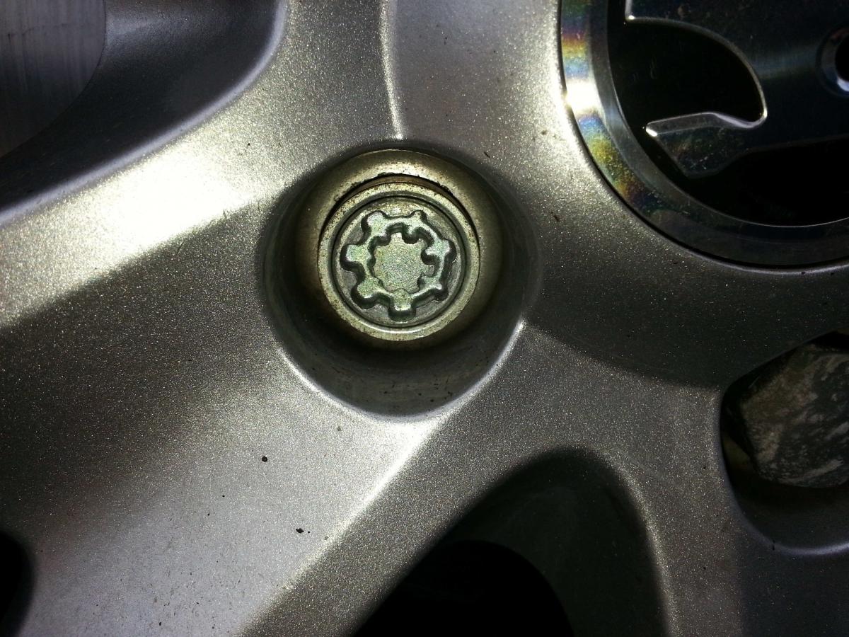

Hi guys,
I wonder if anybody on here can help me. I have a 2010 Superb II and my lock nut key is lost. I've been to Skoda, VW and Audi dealers trying their sets of lock nut keys, but no luck. They claim that they just don't have mine in their kit, but I'm beginning to think that it's not a VW group lock nut (even though it looks damn similar). Can any of you guys help me out, is this a VW group lock nut or should I just give up the search? I know I could get a cold chisel and knock off the outer ring and then remove with a reverse thread lock nut remover. But, I'm afraid I could damage my alloys.

Hi guys,
Owen
That looks like a non skoda / VW group locking bolt, so its no wonder the dealer could not remove it.
You'll need to follow the advise earlier in the thread, and purchase another set (McGard perhaps).
i've just bought a car as a project & 1 of the problems was that it didn't have the locking nut key. The lock nuts are mcgaurd & luckily they stick out a fair bit from the alloys. So all i did was use my grinder to square it off a bit then knocked a 16mm socket on to it then just removed them with breaker bar
Yours luck quite sunken in so if you don't want to try drilling & tapping etc i'd suggest phoning a few garages etc. There are tools out there designed for the job such as dynomec which i've thought about buying myself
Thanks for all the help guys, I'm going to try some of your solutions if the replacement key doesn't work. I've found out that my LOCKING WHEEL BOLT is KEY 766. I can't get this key in Ireland but the lads over on www.skodaparts.com are going to send it over to me. I hope this works so I don't have to risk damaging my wheels. I'll be back on here if it doesn't! And I'll throw the bolts as far as I can when I get them off, nuisance! I suppose the tyres are more valuable than the wheels these days!

Key 766 worked! A relief I can tell you! Thanks to Tomasz at www.skodaparts.com :rock:
