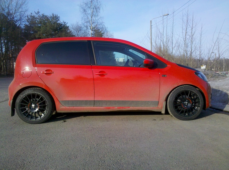

My car is lowered approx. 30 mm and wheels are 7x16ET37 with 195/45R16 tyres. No probs at all...

A little dirty but otherwise good looking car :)
How's the ride? You must have gotten a harder ride that only travels on good tarmac?

Thanks, I'm trying my best to keep it clean but it's always dirty... :wonder:
You don't know Finnish roads after winter, they are awful condition :). The ride was and still is much better than I expected. Feels like a karting car, the driving characteristics are excellent. Suspension works just fine, without any problems even in the worst frost damages. IMO, There is also enough comfort left.
