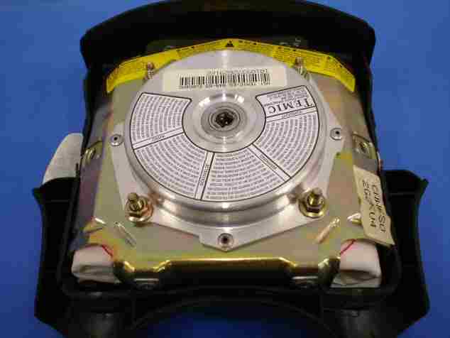

It doesn't look like an airbag. That cover usually has 'airbag' embossed on the front if you have an airbag. This is what an airbag and ignitor unit looks like.

This is what they look like:
In the video after it's blown up you'll see the back of it with the airbag unit itself and yellow connector for it... (around 1:15)
Yeh that's not an airbag, it's just a blank filler piece, that place you marked on the above picture is where the slip ring connects to on models with airbags fitted.
