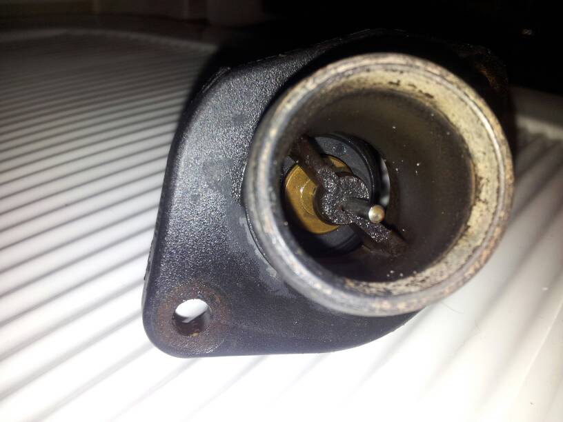

:happy: Before you remove the head check that the thermostat housing internals haven't broken up.
If so are we are saying the thermostat couldn't open, hence overheating?
Ah I see.....http://www.briskoda....mostat +felicia (edit)

Panic over.... failed thermostat housing.
Pin punched a hole.
