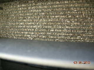

where is condenser? is it the same part with front radiator?

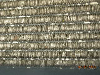

it is the picture made just under the number plate grill, maybe that's the problem???
Yes that's the condenser. Doesn't look in great condition. That could well be your problem. It's hard to tell from the pictures but if it's perforated the gas will have escaped, but even if it's just that air can't flow properly the air con won't work as it should.

It is NOT a condenser problem, if it is leaking you will see some sort of oily patch on or behind it. Get an air con man to test it. It will cost a fortune just to replace parts at will.

Of course I won't replace any parts without air con man coming up. My condenser looks wery bad as you can see from the picture. I was seeing the undercover around it and did not find any trace of leak. Maybe the air con dead for long time...
Yes it looks bad, BUT not that bad the rad (is behind it i presume the engine is not getting over hot ?
It could easily be the condenser. How can you possibly know it isn't without seeing the car. Those photos don't show enough to tell. It needs checking out.
That's my plan to see the dealer or Indy to have a look first. Reckon I be lucky to get only condenser failed. The coolant radiator absolutely fine, keep normal temperature all the time. Love my Octy but no ready to spend so much money on it! Soon I need to replace a cam belt, another £500. Maybe someone know where to take easy money???)))))))
There are two normal problems with condensers. 1 being leakage - you will always see an oily mess on or behind the condenser. 2 being blocked air flow. If you read his last post the air flow must be ok because his engine temperature is fine, ie the air goes through the condenser before getting to the radiator. If blocked - less air to radiator - hot engine.
