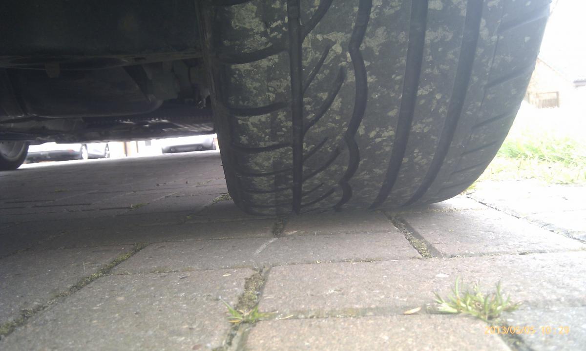

Hi all,
I have noticed recently that the rear tyres on the family vRS estate (59 plate) seem to be getting noisy. I have been underneath the car and took a couple of photo's, (see attached) Is this the start of 'Sawtooth' inner edges?
If so, are these the new settings I need for the alignment?

Sawtoothing happens on the inner edge and is best felt for rather than looked for. Run your hand round the tyre edge. With sawtoothing it will be smooth one way but not the other - like running your hand across a saw blade. Not that I would recommend that! What I think your photo shows is uneven wear but not sawtoothing. I had sawtoothing and it seems to have been largely sorted with re-alignment. But I do have some uneven wear which seems to resemble your first picture.

Thanks for the info, I won't put my hand over a saw blade just yet...... I thought it was sawtooth starting as the car was beginning to sound a little noisy from the rear and I thought possibly the tread pattern was making the noise. When the car was bought it was put on a 'hunter' machine, I presume it was aligned to the correct tolerances, but, unfortunately I don't know if it was the updated settings or old settings, looks like I'm going to have to get it checked over and see what the'geometry' place says. Just thought having 2 quite chunky dogs in the back may effect things over time.....
Mine wears the rears like that. It's not as bad as the saw toothing that some complain about but by the time the rear need replaced the inner edge it pretty knackered. I've not been in for geometry checks.
I think some tread patterns are noisy on the rears because of this. Mine are quite loud right now despite the rears being pretty new with little wear. And I don't have cash to play around with new tyres. When the fronts wear out I'll swap and try a different pattern on the rear.
Inner edge wear is an issue on lots of cars now with wide low profile tyres.

Thanks for the response, I've had other 'sporty' cars and not had any of them make the noise of the vRS and they have quite a lot of camber on the rears-both being BMW's, one a 330d with runflats on and now my new m135i which has non runflats but with sticky super sport tyres on, both of these have 18" 245 tyres on a 35 profile. I think that the settings are slightly wrong on the vRS, but still wonder if having the 'lumps' of dog in the back quite a lot of time I should run less camber. The pattern of the tread on the inner edges does look as if it could be making the noise, as it isn't overly loud, just enough to be noticeable. I may swap the tyres over and see what happens there as I have got different brands on the car.

The Octavia has done 39k on the rears so far, which to me is quite a lot of miles, plus looking at the tread that's left and discounting the odd wear on the inner edge, potentially the tyres could do another 10-15k-maybe it's just the tyres are really hard, combined with the tread pattern and I am just experiencing what others have done so before.
I still think I will get the geometry checked (hopefully I can get this done within a week or so) and maybe get the camber adjusted too as I still don't understand the band that's starting to appear as I check tyre pressures regularly (which I guess rules that out) so again, camber comes back into the mix, as it can be quite noisy and I'm all for looking after the tyres on cars and not wearing them out just for a lack of 'maintenance' and if they do another 12 months or so they will need to be changed around the same time as the fronts too. The rear tyres are Dunlop SP Sport 01.
