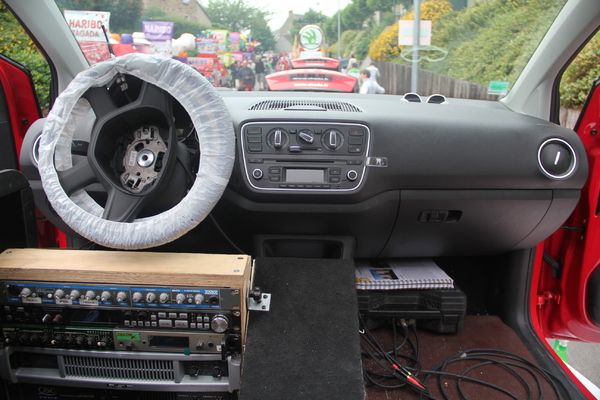

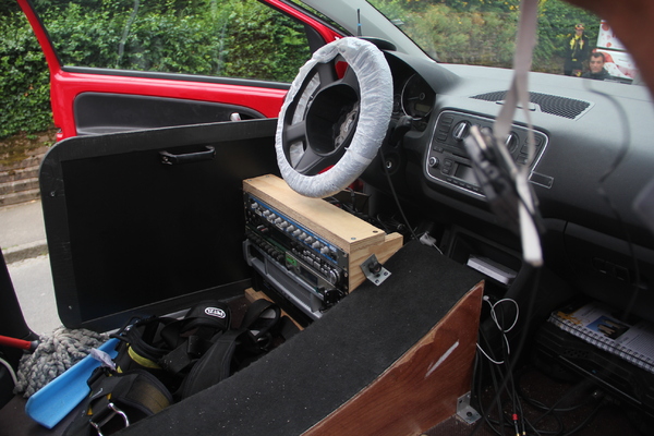

Here's a 'proper' upgrade to the citigo sound system.
It even has it's own PA system.
It's so well integrated you can hardly tell it's been modified. LoL!  :rofl:
