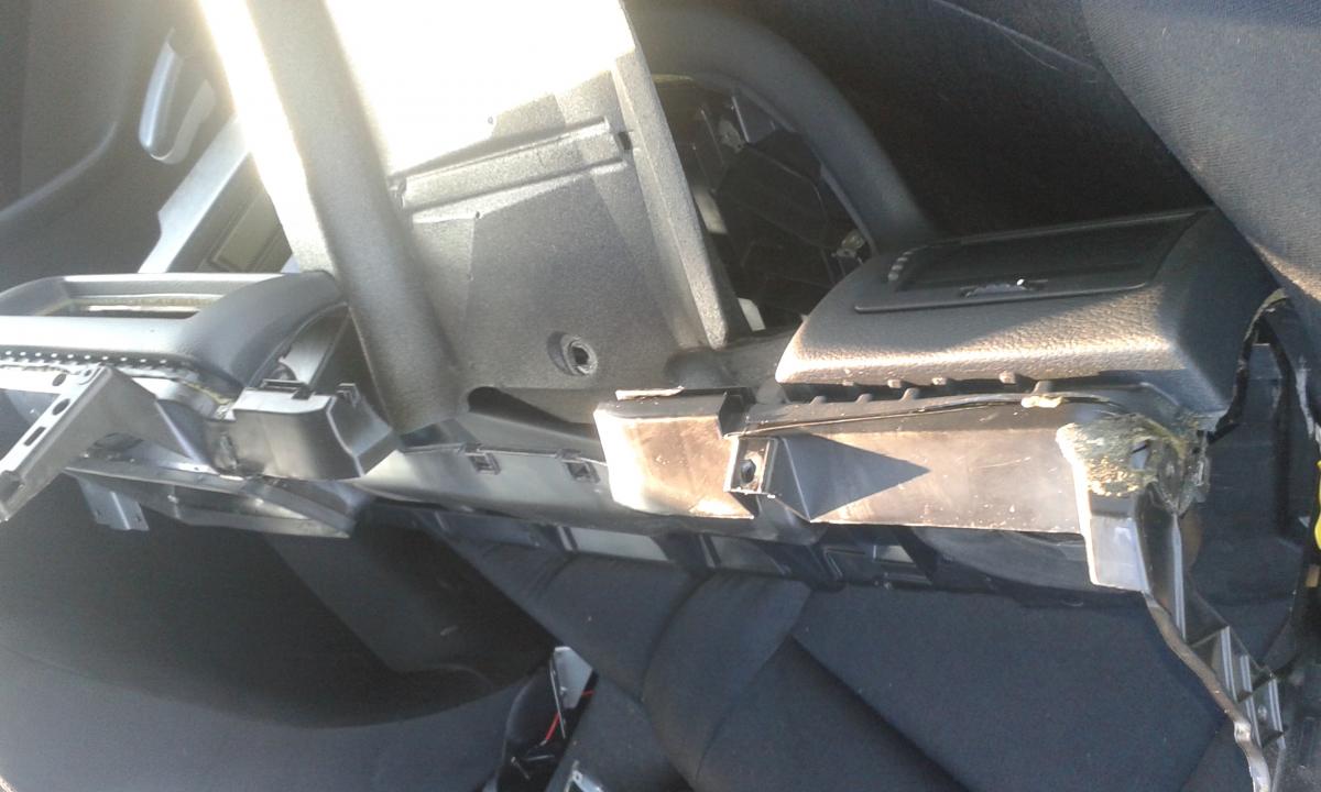

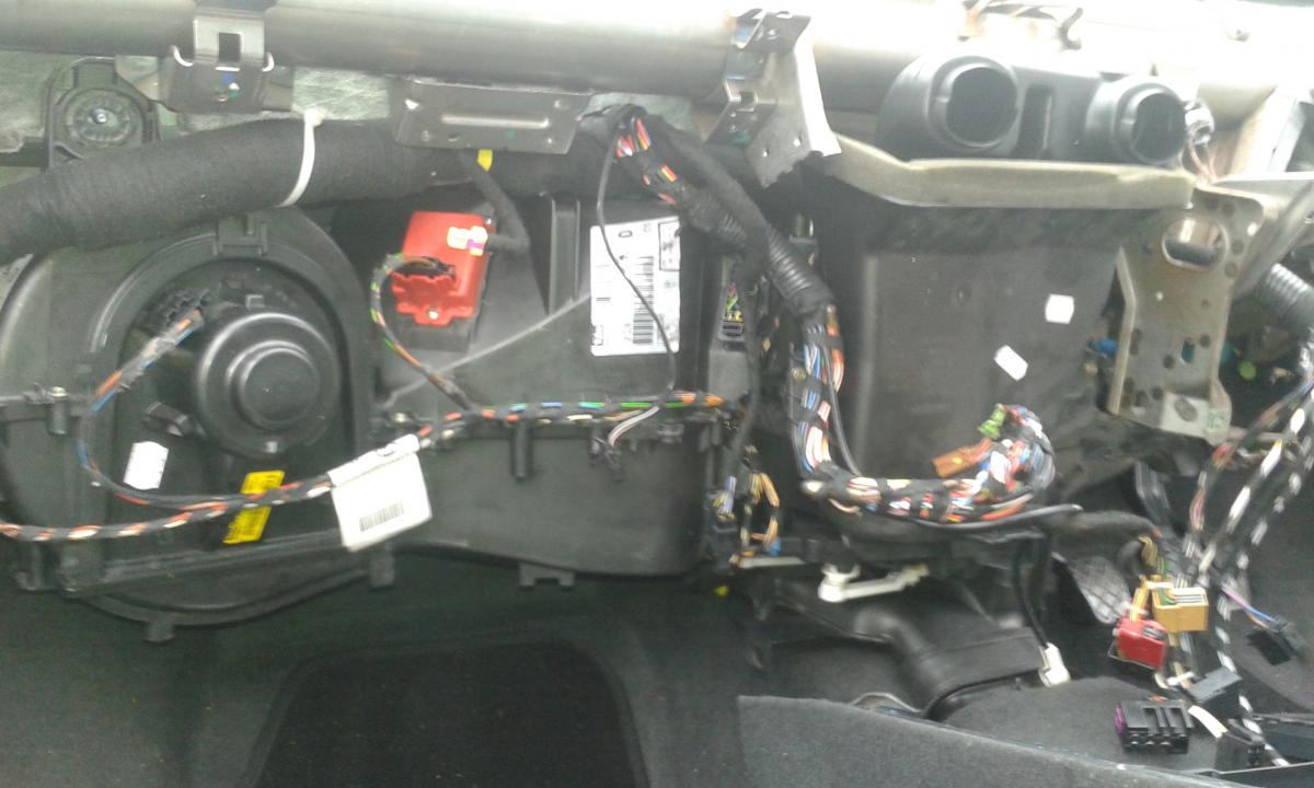

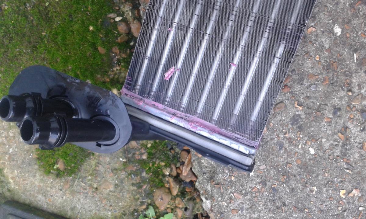

All this to get the heater matrix outpost-55746-0-02902900-1483015521_thumb.jpgpost-55746-0-65976900-1483015549_thumb.jpgpost-55746-0-03397400-1483015569_thumb.jpg
  • Replies 241
  • Views 30.2k
To remove heater matrix.

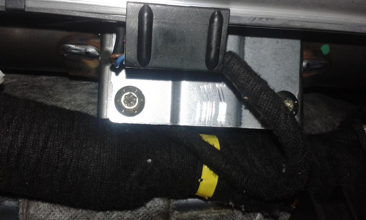

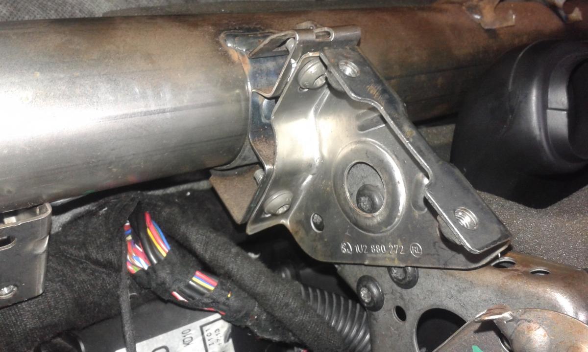

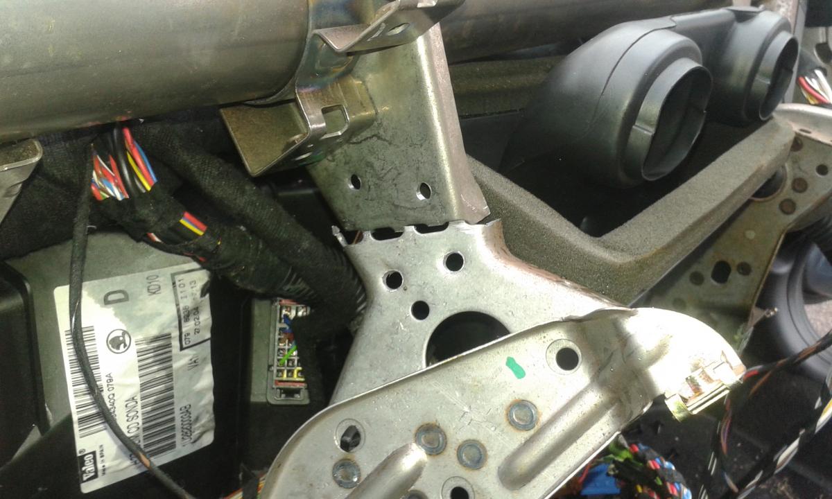

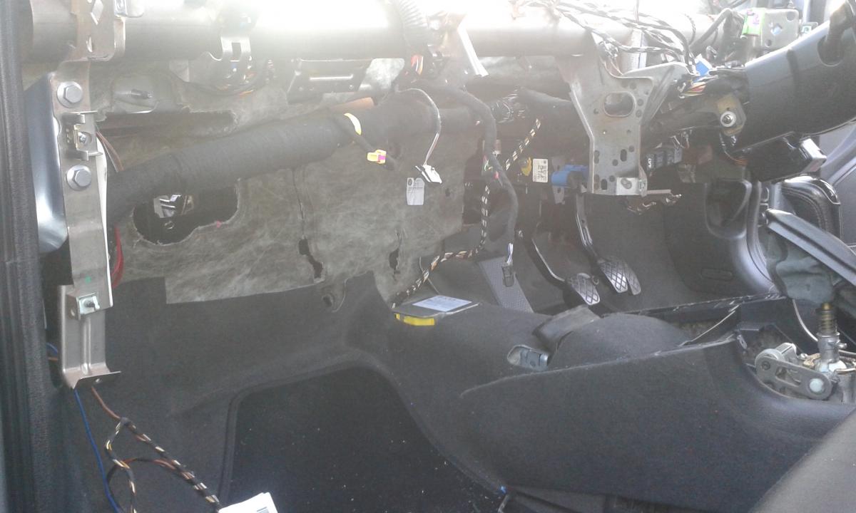

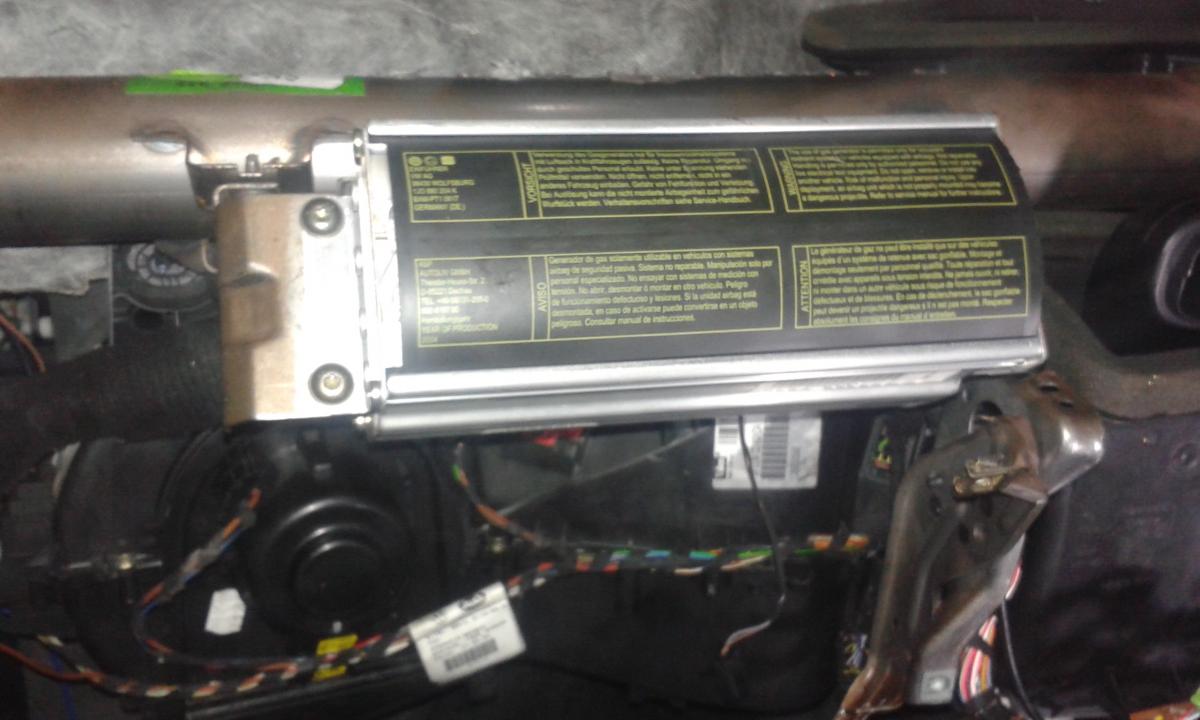

You need to remove center consel and clocks, then set about removing all of the screws that hold the dash on.post-55746-0-17570200-1483130847_thumb.jpg These two screws are hidden behined the air bag.

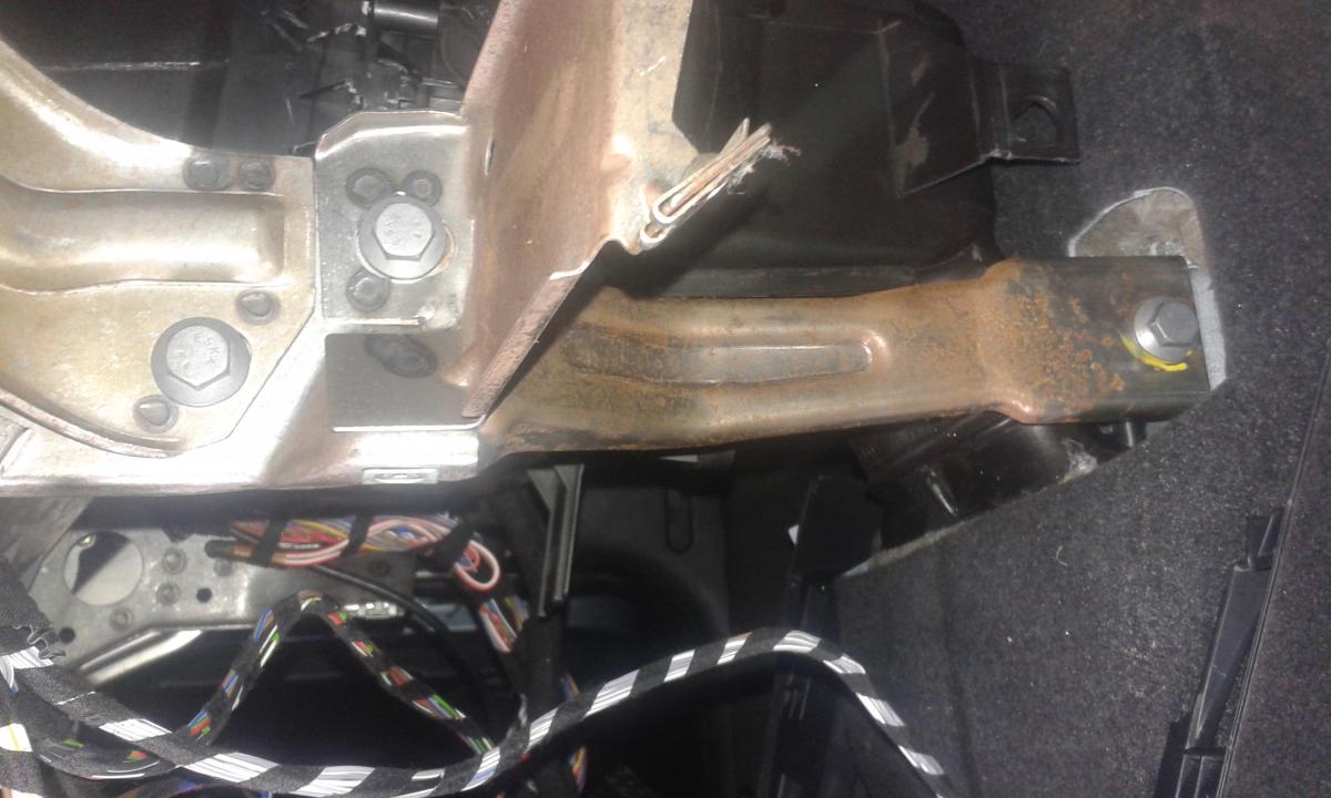

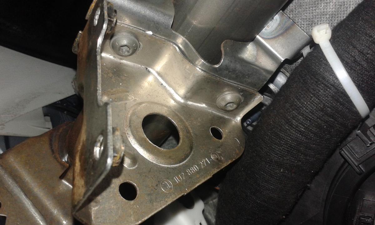

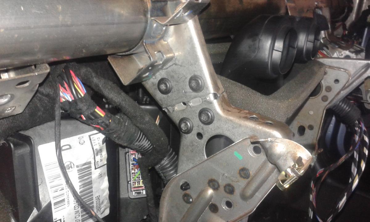

This braket has to be cut and the rivets drilled out.post-55746-0-51273100-1483131613_thumb.jpg
Remove air bag post-55746-0-77269800-1483131465_thumb.jpg Unplug all of the plugs. post-55746-0-97101600-1483131670_thumb.jpg

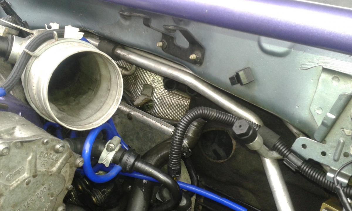

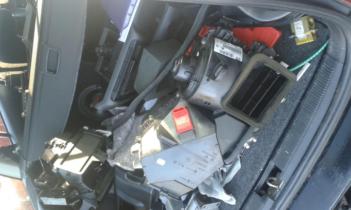

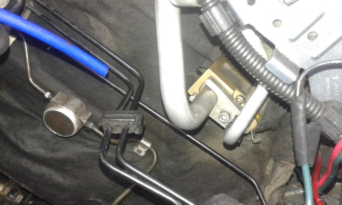

Then in the engine bay you have to disconet the aircon pipes and the water pipes at the bulk head.post-55746-0-87510700-1483131762_thumb.jpgpost-55746-0-74393800-1483131832_thumb.jpg Also in the bulk head behined the fabric there is seven nuts to undo. Once the whole air system is out you have two nuts on the matrix to undo then then the matrix is free to replace post-55746-0-54967900-1483134332_thumb.jpg.
It takes about 8- 10 hours if you are doing it by yourself

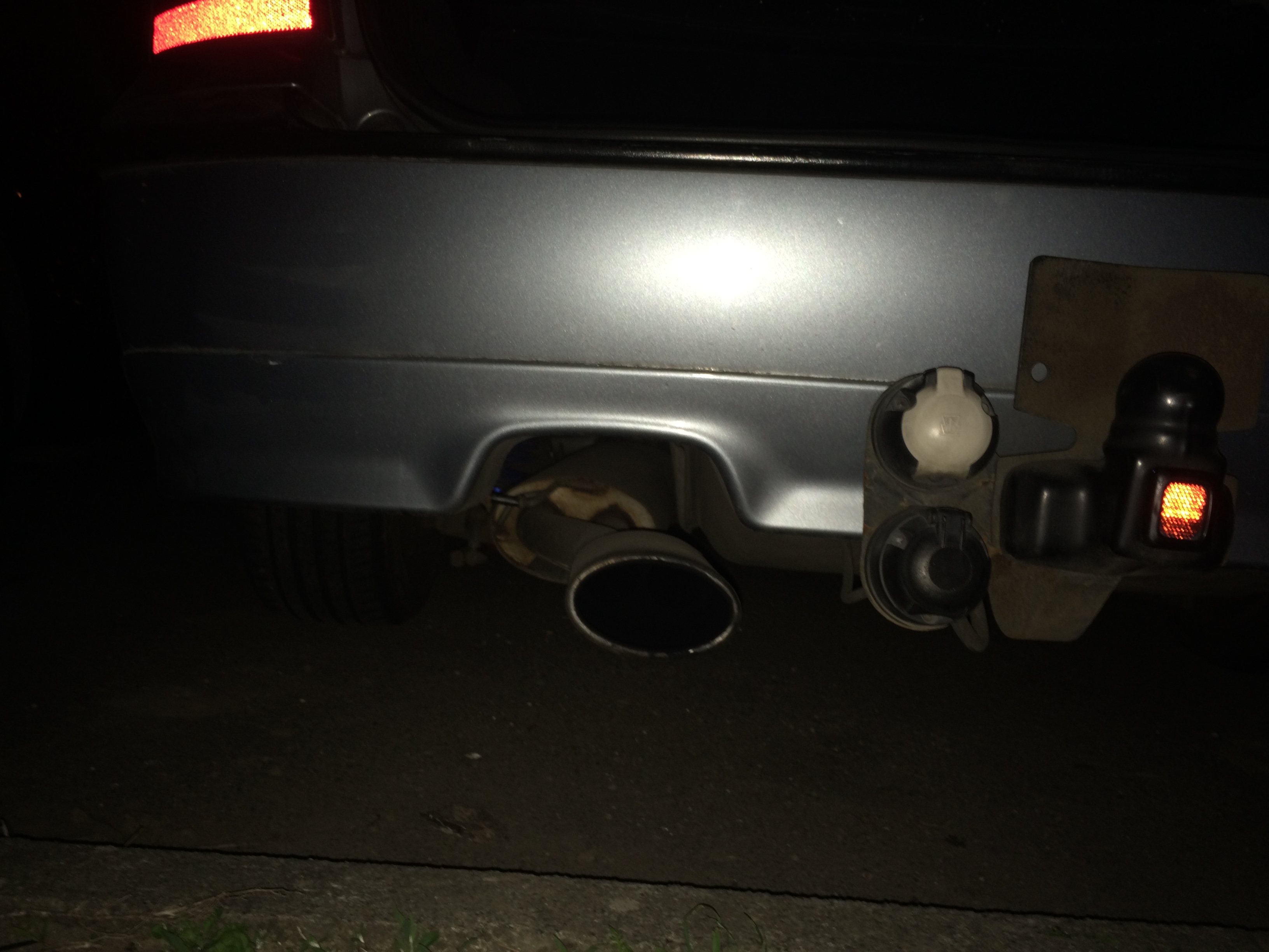

Nail in the coffin four exhaust mounts broke and a hole in the down pipe time for octy to go to bed will be brakeing so if interested pm me IMG_0238.thumb.JPG.4ed0cba37d4dc59a6b3ace9c45891983.JPG

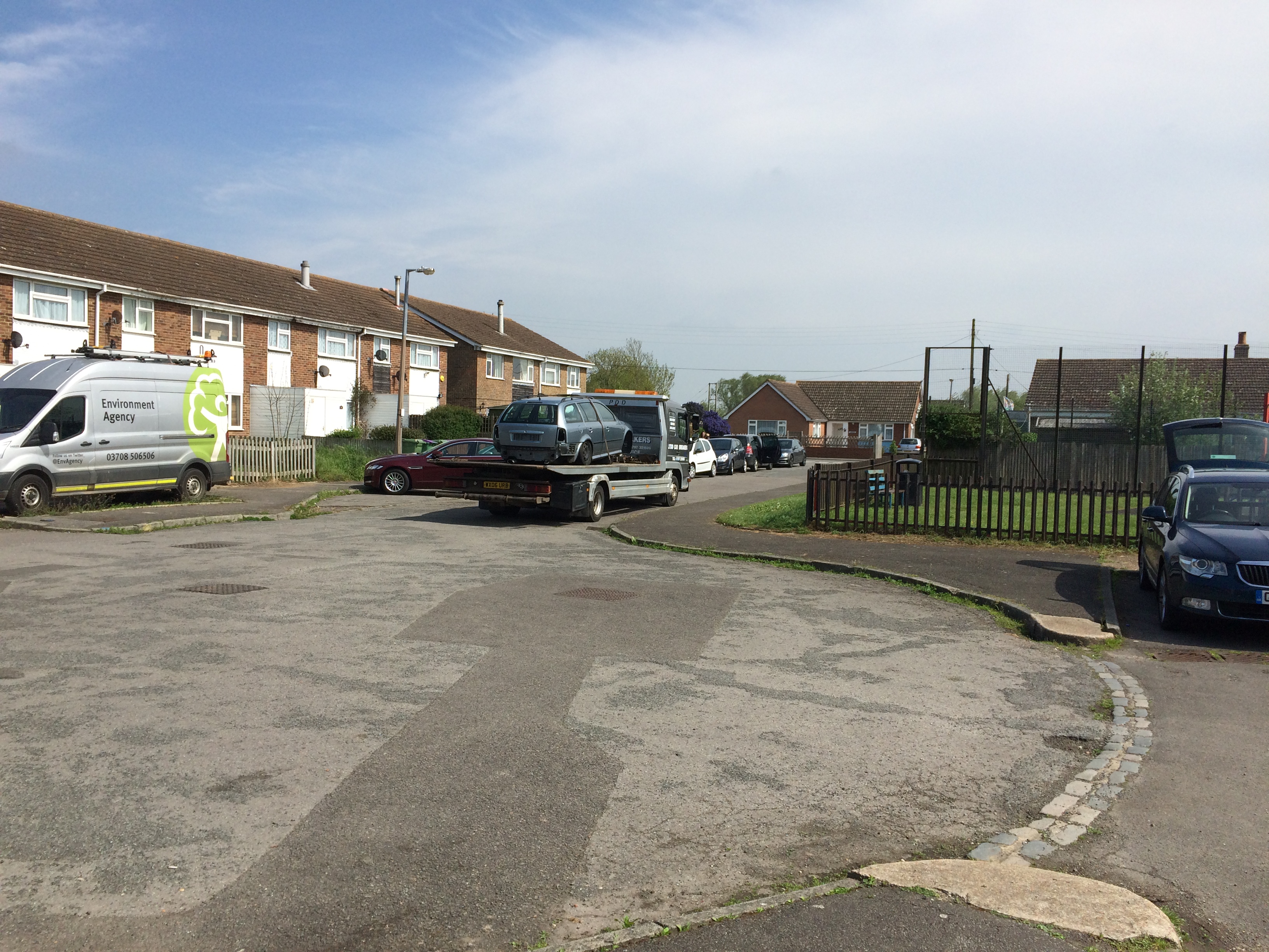

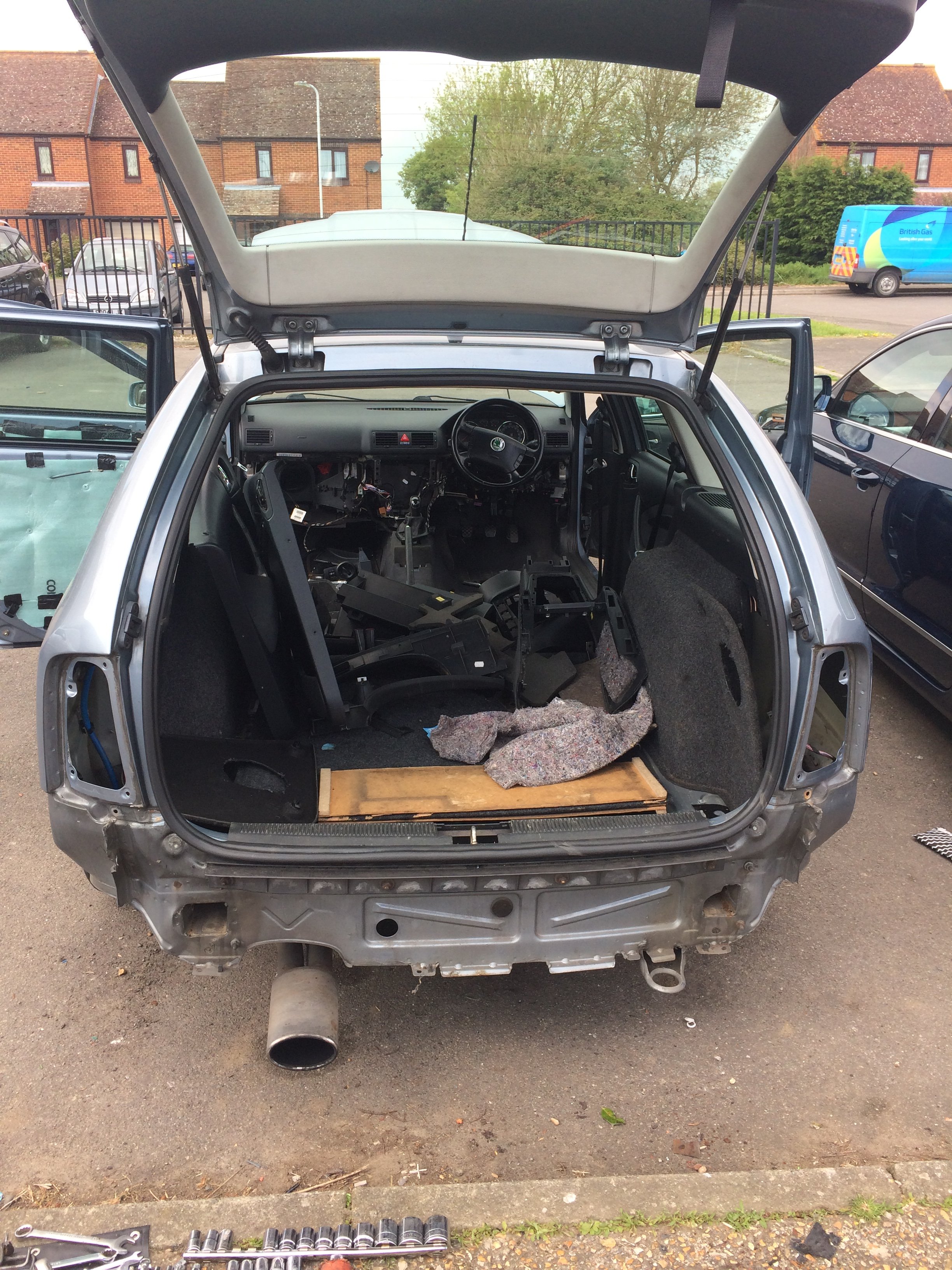

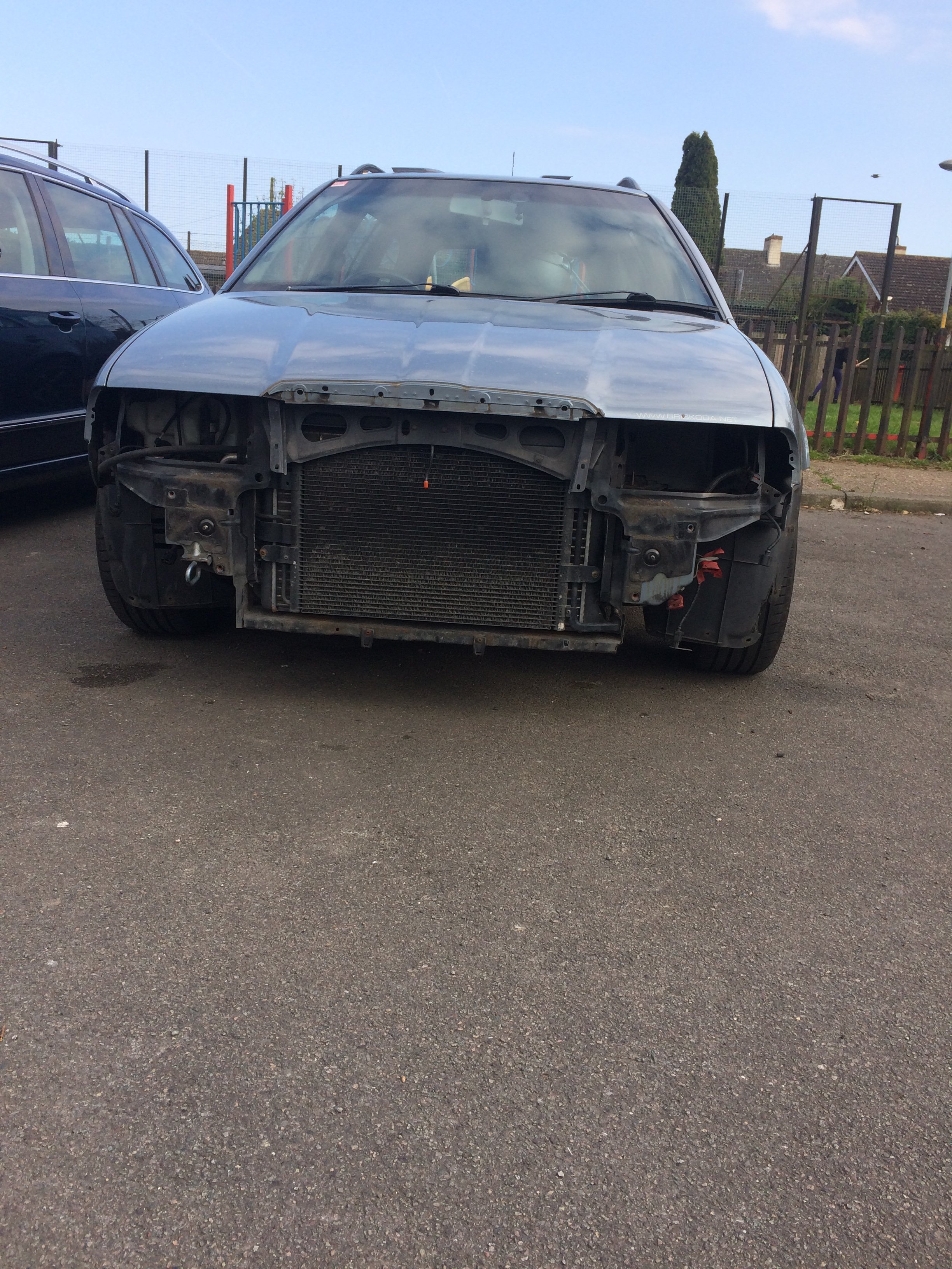

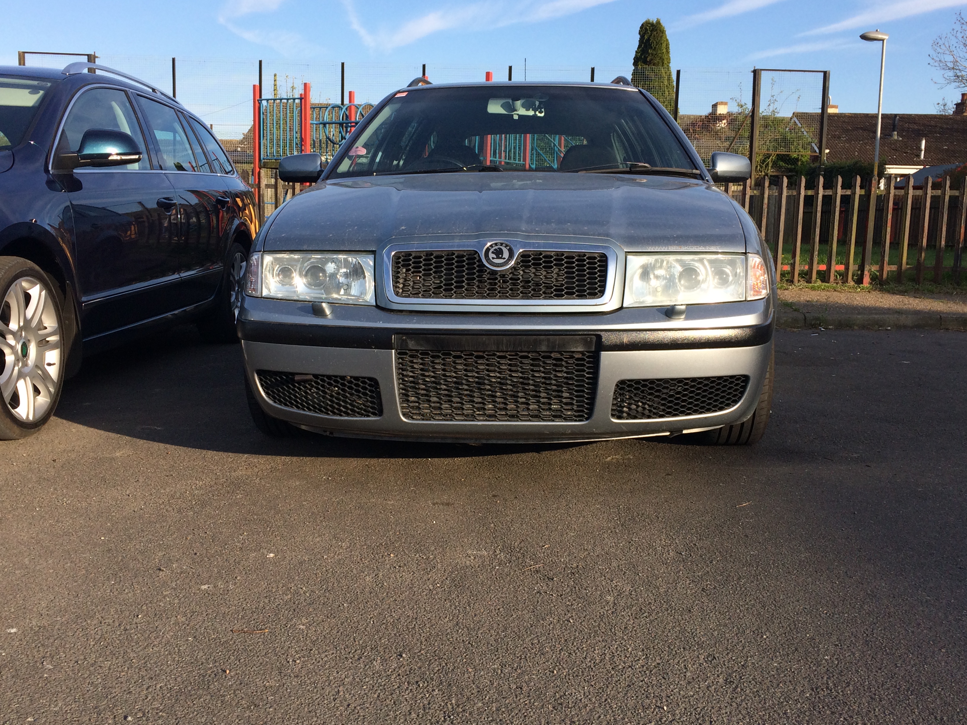

Last pic of octy before it's taken apartIMG_0247.thumb.JPG.a1a5143d8ee5a166889da5311d867706.JPG
So a few hours work and the car looks this
IMG_0252.thumb.JPG.c28ddbe9ec031a5addedeb9c609ab5bb.JPGIMG_0261.thumb.JPG.21a5b5bec78fe1b5c19e34925d19c6f8.JPG
the interior is completely striped, the rarb, the lights, the wing mirrors and some of the front end are off.
