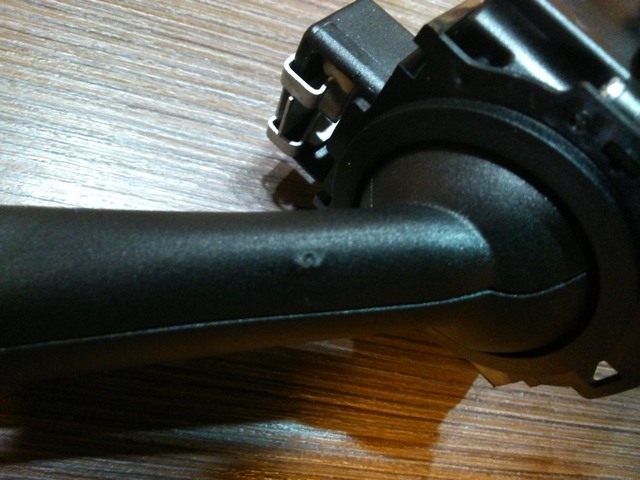

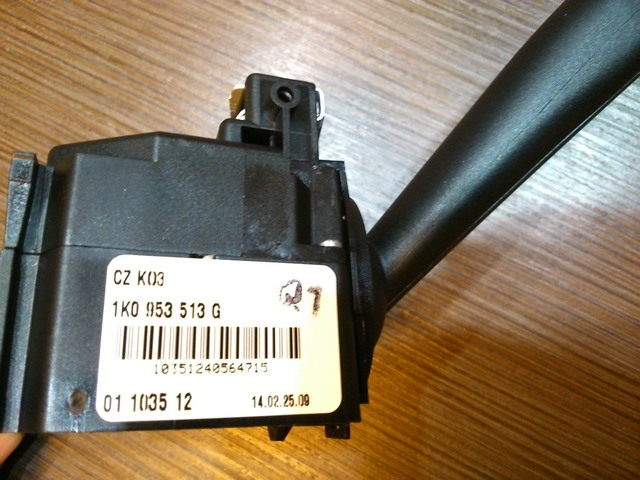

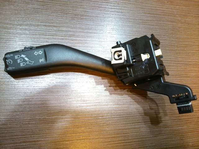

This is the cruise control stalk that just came in from China. I doubt it is, and probably it is not, an original vw part, but it looks and feels like a real thing. It’s perfect apart from that tiny little spot on the back of the lever where it seems like plastic did not properly melt, or mold, whatever. It’s hardly visible, and only if you stick your head behind a wheel and look for it. And you can’t beat the price, for $28 with free shipping it’s almost free. It took mail system three weeks to deliver the switch, and I’ve got all the tools in the meantime, including vcds, so now looking forward for some spare time to put it in. Though there is plenty of instructions around, In case anyone needs the guide here is the official Skoda cruise control retrofit guide.
