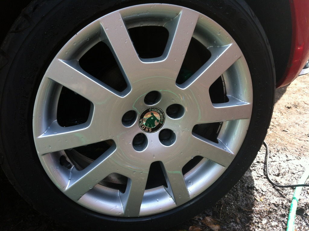

I've just done mine... I snowfoamed them first, followed by a jetwash and then an application of bilberry wheel cleaner 1:9, let it soak then a careful clean with a good quality wheel brush with extra bilberry, then jetwash again. Then I took each wheel off, applied iron x jet washed and dried with a mf towel. I checked the wheel was totally clean, if not I used more bilberry on an mf cloth Next I applied anglewax bilberry wheel wax as per instructions, applied a light coating of copper grease to the hub centre when the wheel marries up and put it all back together at 120 nM!
So you physically took the wheel off?
Yep... Sad innit! It's the only way you can get to all of the wheel to wax it-the wax is supposed to last about 6 months so I'll do the same around September/October time when I rewax her ready for the winter. In the meantime it'll be the snowfoam/ jetwash/ bilberry wheel cleaner/ jetwash/ more bilberry/ gentle brush with more bilberry/ jetwash/ dry with mf towel routine. Sounds a lot, but if you do it as you clean the rest of the car it doesn't take that long. Others (who have been at this longer than me) say the secret is to keep them as clean as possible as the wheels take a right pounding with crud/brakedust etc. I used a trolly jack on the suspension rather than the skoda scissors jack with a axle stand for safety next to the jack in case. HTH
