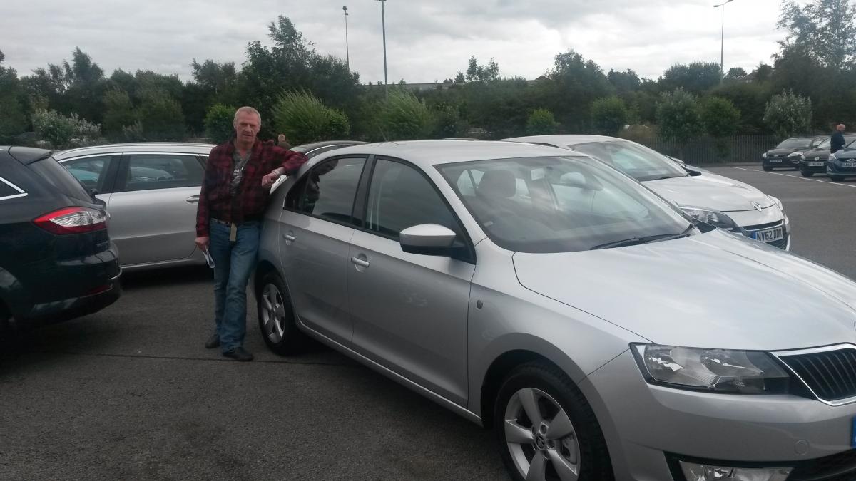

Almost 2 weeks since the dealer mod and no sign of water in doors after substancial rain, Weather permitting I may wash it today and see how it holds up to that.
well after a good soaking and washing everything seems ok, no water in doors.post-107277-0-64802600-1381075321_thumb.jpg
