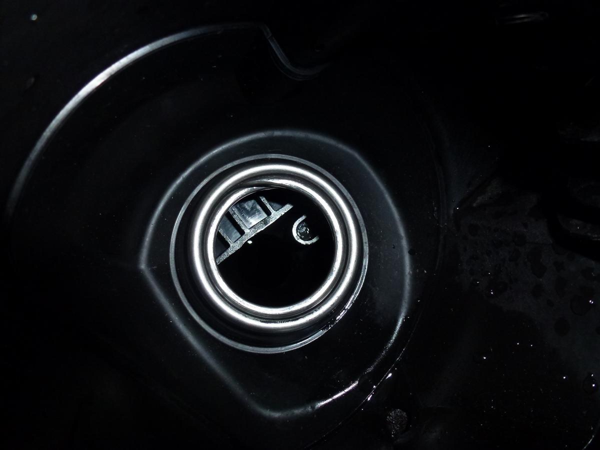

Ejstubbs, I think some of the problem is caused by the design of the filler neck on some cars, petrol or diesel.
Some is caused by the subtle design differences in the nozzles, which might explain that different company forecourts are more prone to the pumps cutting out.
The third factor could be the flow rate of the pumps. Some have a higher flow (I was going to say 'pumping' but i'm not making it that easy) rate so are more prone to fuel backing up in the filler neck.
I've noticed that Esso stations seem to fill the tank quicker that the Tesco stations round here.
My diesel has a different fuel filler hole to that?
It certainly doesn't have that little plastic "mod" on it.
Thinking about it, as the petrol "nozzle" is thinner, i'd expect those to have a misfuel protector on it and not the diesel?
O and whoever's image that was, you've dribbled a bit. :giggle:

I think this is what the good lady is talking about .

The item in question slightly blocking the filler neck is the vent outlet which runs up the side of the filler pipe from the tank.
Petrol cars have a different filler due to the smaller nozzle on forecourt pumps and the later 2wd diesels may also differ in design, as they have the conventional golf VI fuel tank rather than the Tiguan saddle tank of the 4x4 and MY10 2wd.

Well good evening gentlemen and thank you for your spirited responses. I shall stop panicking now that there's something wrong with my Yeti as it is indeed like the image that Wakev posted.

:notme: that will be SWMBO then, always gets it down the paint and on the floor :giggle: , and that drain hole is blocked again always cleaning it out.

Ta muchly. And am learning to live with the weird filler nozzle obstruction thingy :-)
