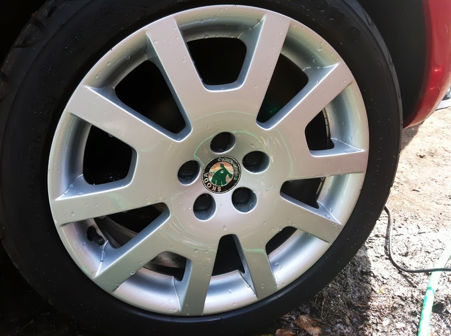

Wheels were a bit messy as well so they got just as good a tretment

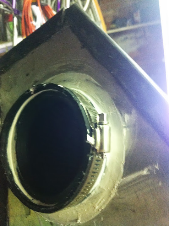

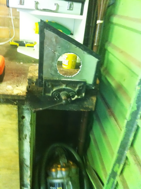

Came across the jabbasport cone in box air filter, did some more digging and also found a topic on one that someone made. So i decided it doesn't look that hard to make...
So cut the aluminium to shape with an angle grinder and metal cutting disc and used a tool to hammer dimples around the inside of the marked circle as points to drill
So drilled the middle bit out and started grinding to make it a nice circle
The cone fits!!! :rofl:
Sealed it up with sealant (looks messy i know but tidy up process is saved till the end)
Rubber ring and jubilie clip used to make sure it wont fall out of the hole
Test fitted it to the car and fits like a GLOVE!! Tidy up process still needs to be done and may change the rubber edging.
