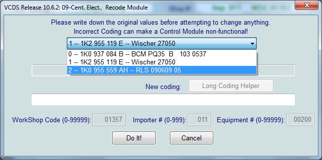

You were in the wrong controller.
You go to 09 Central electrics but don't go straight into the long coding helper.
There should be a drop down list, choose the bottom one RLS:
Then go to long coding helper and the option should be in there.
Phil

  • Just an update on this.   We just had the laptop on silver1011's superb SE. Got auto wipers activated with one click. Just needed to untick the box that said something along the lines of "rain senso
  • Yip. Done in about 30 seconds flat. Easy when you know how. Big thanks Phil. Oh the wipers on the bus go whoosh, whoosh, whoosh, all by themselves.

Hi,
Phil

For anyone interested in doing it.
It was in 09 Central electrics. Then on the drop-down menu choose the bottom one (something like ALS). Choose the long coding helper.
Then it's in the first byte- untick the box that says "rain sensor inactive".
Done!
Phil

Yes you have the sensor, if you have the light sensor (auto lights) then you have the rain sensor too.
I'm afraid the dealers don't use VCDS, they have their own software which isn't quite as comprehensive so it is very likely they are telling the truth.
You'd be better getting a discount from the dealer and then finding a local member with VCDS and ask them to follow the instructions detailed in this thread.

I met up with a local member, Jamie this afternoon who has VCDS, once he had connected the laptop he had the rain sensor deactivated (unticked) in Central Electrics 09 and I was up and running.  The dealer has ordered me rear blind so overall a very happy bunny.
A big thanks to Jamie for setting up for me and to Silver 1011 for his helpful replies to my posts and Phil for the info on setting up the rain sensor in General Electrics.
