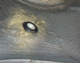

Pic 1 Outer liner fitting with some Waxoyl

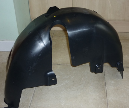

Pic 2 Inner fittings with Waxoyl

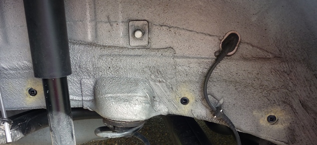

Pic 3 Markings to adjust liner for mud flaps

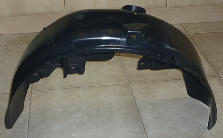

Pic 4 Finished with mud flaps securing the rear.

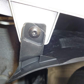

Pic 5 Bottom rear fixing by replacing the original small head screw and fitting one of the hex soc head screws.
