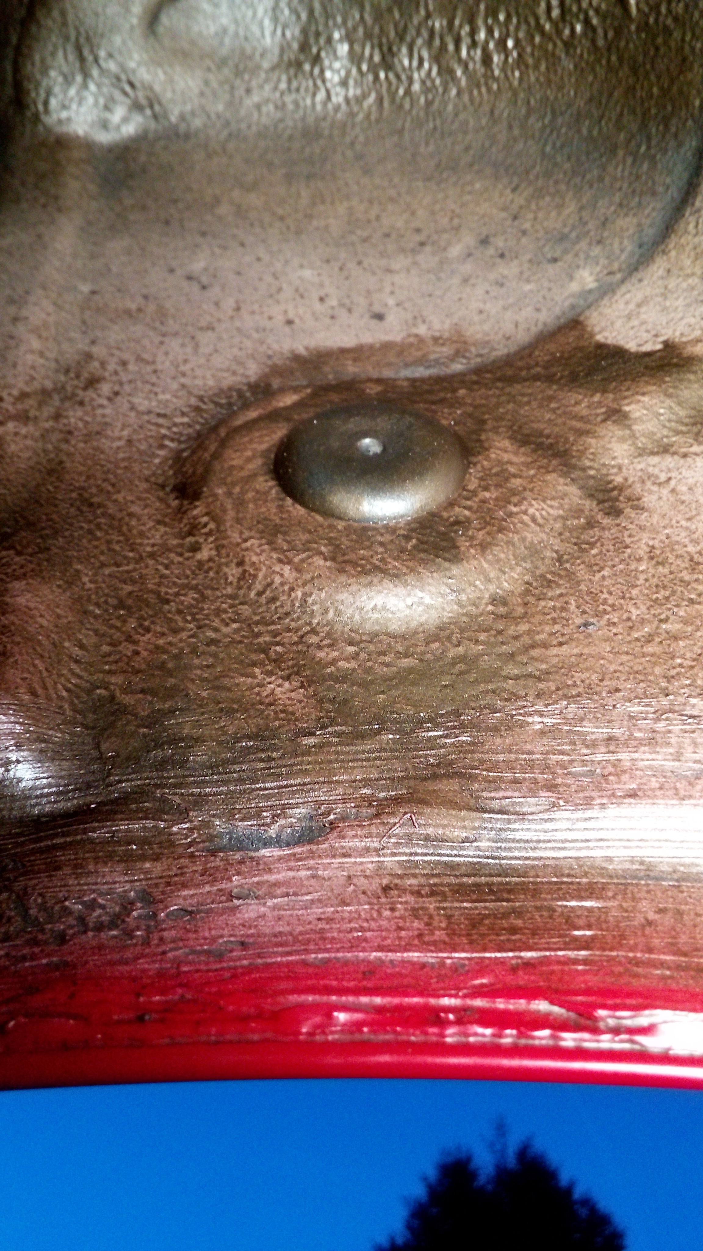

As an aside, one of the most common places that cars corrode is round the rear wheel arches due to the way that the manufacturers wrap/bend the steel sheet to form the wheel arch seam. I had previously been intending to strip out the rear side upholstery to get at the inside of this seam, but I discovered when looking for fixing points that there is a round rubber bung that can be levered out with a small screwdriver (see picture); from the bung hole, the complete seam can be sprayed with (in my case) Dinitrol penetrating cavity wax. It's obviously much easier to do this BEFORE fitting the wheel arch liners.

Edited by allanhodgson
Pictures interfering with text.

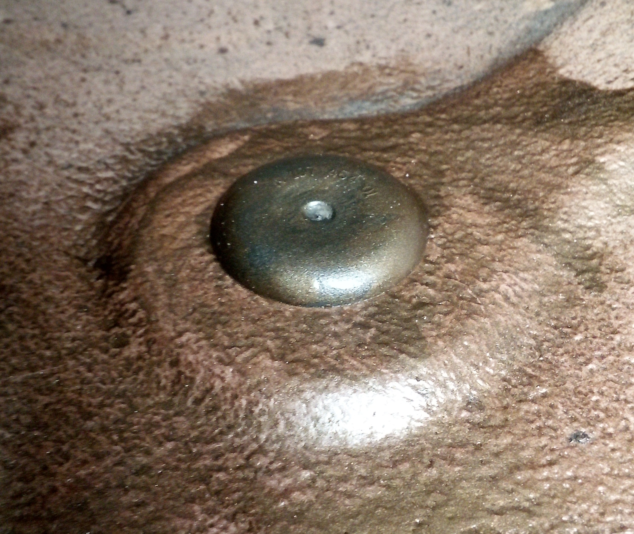

It appears that early citigos don’t have holes in the body to fit arch liners. Mine is a 62 plate. I spent all morning poking around with a small screwdriver. I scraped an patch of sealant off in the area where one of the holes should be after studying Owen’s photos in his tech guide and there was no hole.
I’m deciding whether to drill mounting holes or give up on the idea and put the parts in the For Sale section.
Its a bit difficult to see because of the cavity wax mess. My car above compared with Owen’s below.
