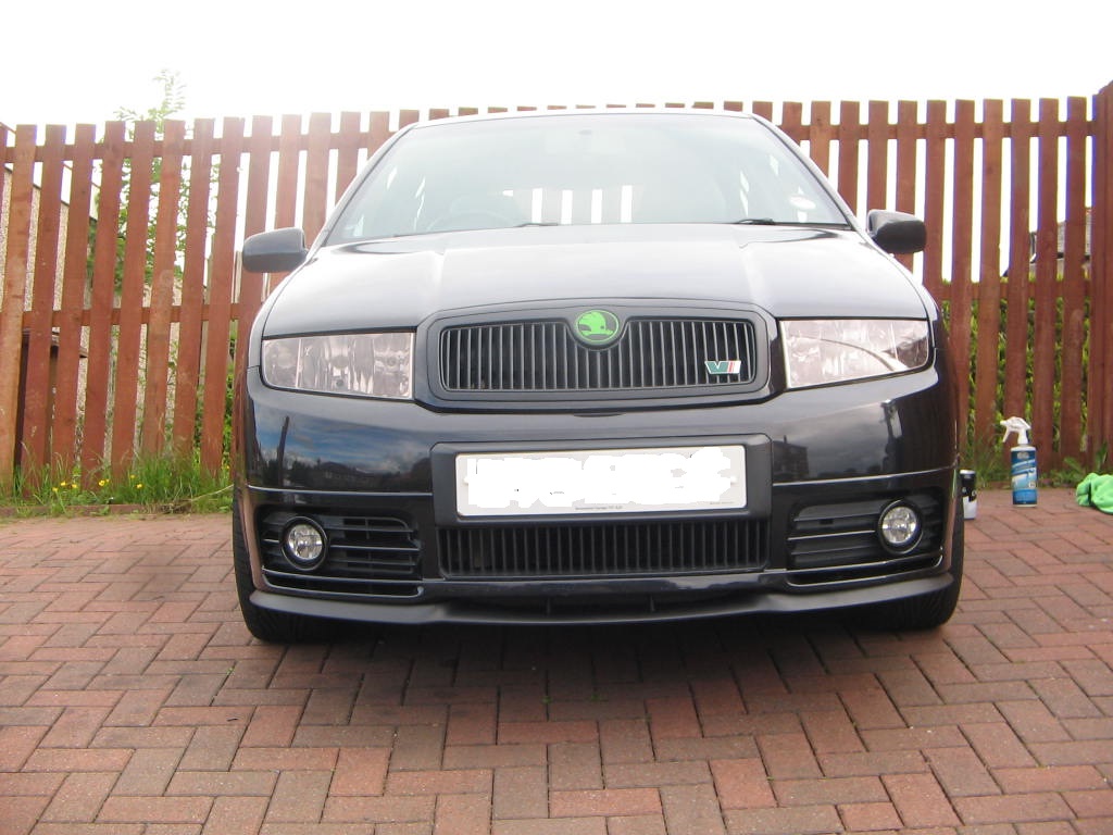

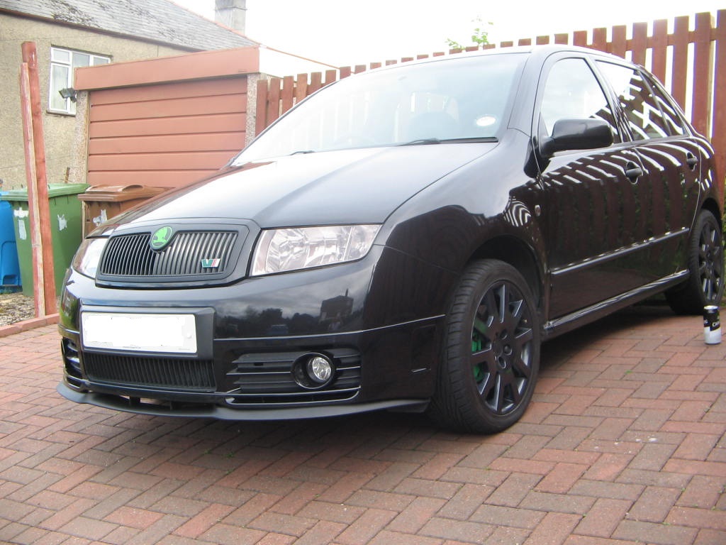

Just got around to putting on my cupra r lip spoiler today

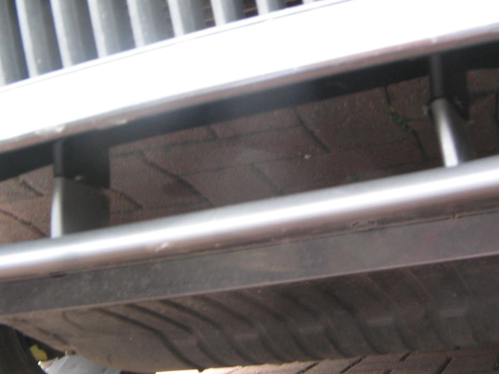

Just got around to putting on my cupra r lip spoiler today read the how to post but had a wee bit of trouble fitting because of the two wing clips in the middle but after a bit of measuring and cutting out some holes I think the fit is much better than cutting them off and screwing and glueing them on what do you think
nice job :)

looks good you need to fill the centre in though to make it follow the bumper

Thirsty work mate, love the tin of Carling in the pics. lol, seriously VRS looks ace.

What length self tapers did you use? I think 20 is too much haha
10 mm self tappers I found it a wee bit tricky to get it in the centre you need someone else just too hold it in place.I screwed from each side of the opening and cut a little more than 3cms from each side that needed trimmed
I left the long sides on for fitting , they clipped on wheel arch nicley t hold in middle, then 8 self tappers

Mine's not screwed or glued in the middle.
Have found that means that if you nudge it into a high kerb it just flexes a bit rather than ripping screws out of your bumper!

- Oh and you don't need to trim holes in the bumper to get the same shape as that....you trim the lip down instead :rofl:
£36 trim cut down or expensive bumper with holes in it....erm, I think I'll take the latter :giggle:
Still, well fitted, well done
like the alloys, what colour are they? i've just had mine done in gun metal grey, look the business though. B):thumbup::wait:
