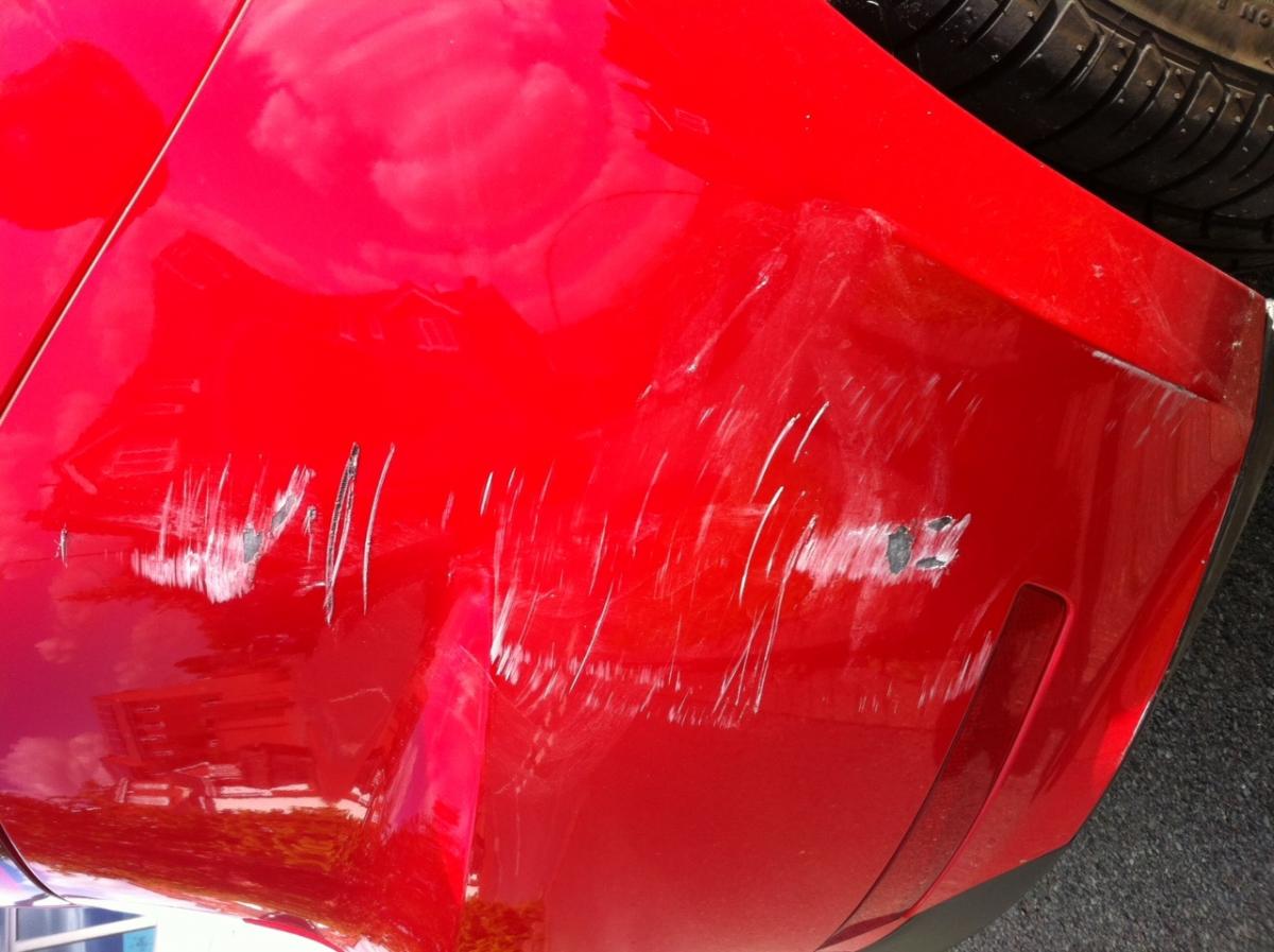

Somebody scratched my rear bumper while the car was parked. He was nice enough to leave his number but still :(
I managed to clean 99% of the black stuff with some 'asphalt remover' (he says it was his black rubber bumper that did the damage) but I have a number of small scratches left on it along with a few black patches on the edge (to the left in the picture below).
Anybody know if the bumper (which is plastic) would need a complete re-lacquering (even re-painting) or if it is normally just fixed 'locally' on the individual scratches?

That will possibly polish out. But I'd be wanting a home address and cash within hours if he wants to go outside of insurance. Any umm-ing and ah-ing, then just call your insurance and let them deal with it.
All depends on how deep the scuffs and scratches are?
I presume the photo is as it was just after the event?
How does it look after you've cleaned it up?
If none of the scratches go down to the primer you may be able to just polish them out using Tcut or similar.
Alternately, you could use some very fine wet and dry (1200) to rub down the worst and then use Tcut to finish off.
Word of warning though.. Be very careful on and around the sharp edge of the wheel arch, its very easy to overdo it.

The image is the 'before' shot for documentation - I did not see it happen but noticed the note in my window today.
It is hard to see anything after I cleaned it but up close I see the scratches and I feel them with my nails - but they are not very deep. It's the wheel arch edge where the black stuff is still visible.
What color is the bumper under the lacquer and paint? Maybe the black stuff left is the lacquer and paint gone all together - if the original colour is black/grey.
The bumper will probably be black underneath when the paint and undercoat is removed

Only way to tell for sure is to find an area that's hidden and scratch down through to it.
I'd have a good guess the primer will be grey.
I still think your best bet is giving the scratches a gentle rub down with the wet and dry, used wet, first. The paint is reasonably thick. As I said before, just be very gentle.
If it cleans up OK then result.
If not then you haven't really lost

Just a small point, in the photo the alignment of the two panels seems to be slightly misaligned so there may be more damage than is first thought. Recently we had a car collide with the rear of our Mazda 6 and the plastic valance had sprung back into place. It did not look damaged at all. On inspection we found that the rear cross member behind the valance was badly bent and had to be replaced and the chassis welded to make the vehicle safe. Collision speed approximately 20 mph.

Try 'Autoscratch.co.uk', they just did my wife's car for £95 and the damage to her rear bumper was worse than what yours looks like(see pic).
They give a 2 year guarantee, do the job at an address of your choice and the bumper is now as good as new again.

My dealer will do a full respray of the whole rear bumper. There was no structural damage.
Price is DKK 4.200,- or GBP 480,-
The guy who did the damage accepted to use his insurance.
However, I have to wait until early September before they have the time to do it.

Why does the whole bumper need spraying? Only the damaged area needs attention. Maybe your dealer is just trying to get as much money as he can out of the job. ;)
Probably - and I would have looked elsewhere, if I had to pay myself.
I too think it's a little over the top - but I do prefer having a car with no 'hidden' scratches. A full respray is the best option (and the most expensive).
