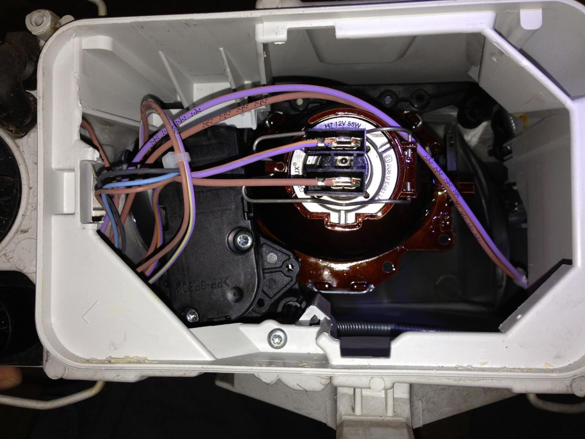

I'm going to France next week and need to sort out my headlamps. I was under the impression it would be easy to flatten the left kick in the beam but comparing this thread http://www.briskoda....ts#entry2867266 to the headlights on my 07 Octavia shows little resemblance. it doesn't look there are any levers at all in my headlights to adjust the kick. Can anyone help please as I don't really want to use those crappy stickers...
This pic is what mine looks like inside...

Sorry dude, I cannot recall the layout exactly for the pre FL's and if all models had this not just VRS etc... I think from memory that the pre FL had a single lever to move unlike the double one in my pics. Carl's site is down where the guide for yours was now and even finding the archived version the pics are not hosted any more.
Here is a link to an archived version of the octavia-vrs site which had the pre fl guide (minus pics) the talk through says a plastic lever etc Says it is in past the bulb, so try removing it too and look for the little lever in there.

nope :p I am just not sure if it was every model or just VRS's but it was available in the same way as it is in all FL's, obviously with a different designed unit.
Mine had the lever ( non xenon)

take back cover off, use fingers to feel leaver, it goes slightly up or down.
Best thing to do is turn the headlight on and face a wall so you can see the change.

You need to remove the bulb to get to the lever!
