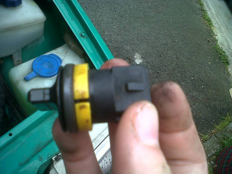

Our 1997 Felicia 1.3 MPi needs a new temperature sensor but I can't find a new one. Both the ones my local motor factor had on offer weren't the right ones and neither do ECP or Skoda seem to have it. I am beginning to wonder if its the wrong sensor in the first place. I've attached a picture - does it look right to anyone else?
Alternatively I have a thermostat housing from an earlier SPI engine, the metal housing. Is it possible to swap the later MPI plastic housing with the earlier one?

That's the right sensor.
No, you can't swap the other one - the MPi one is two in one - one for the ECU, one for the gauge.

today temperature sensors look different from those in 1997.
the most important thing is to buy one having the same ring color.
Ah really? I've seen them like that but assumed they were different.
