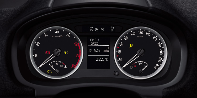

Trying to get to grips with the controls and can't seem to be able to find a way to change the electronic speedo reading from km/h to mph. Can anyone help?

does it have Maxi-Dot, if so then it can be done without VCDS I think.
Maxidot display

Just done this recently and its a little code change in VCDS (to Aus) then two changes in Maxidot.
Very simple.

Maxidot in the Fabia is a Lite version of that in the Octy/Other Models
Indeed. Believe the controller on the Fabia is a midline one so is unable to be set up to control many of the cars settings via the Maxidot settings menu. On an Octavia etc you can change many of the convenience settings, down to setting the alarm bleep, turning the DRLs on and off and telling the rear wiper to wipe when the fronts are on permanently.

I've done the mod on mine. Yes, you need to get a nice member to change it to AUS and it will come up as a option. I can show you pictures of my maxidot display if your not sure how it all works. :)

It is possible. And you use the Fabia Maxidot after changing the country code with VCDS.

Once set in VCDS it is still possible to set the digital display back to KM/h when you want to using Maxidot.
