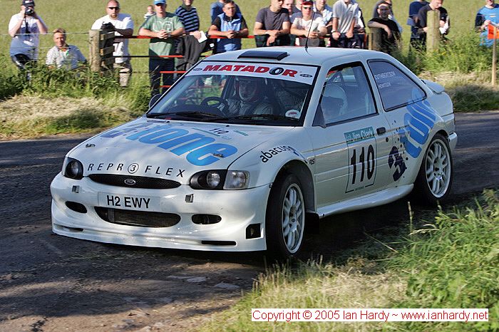

Jase are you running 18" wheels?  I ask because I might be getting some 18" part worn slicks, could pass a few your way.
Nope - 17s.  18s don't fit under the arches, and I wouldn't fancy trying to run the silly low profile you need on 18s, on a trackday. :)
The profile is quite good, the tyres are off an Escort Maxi RS2000, this one to be precise.
