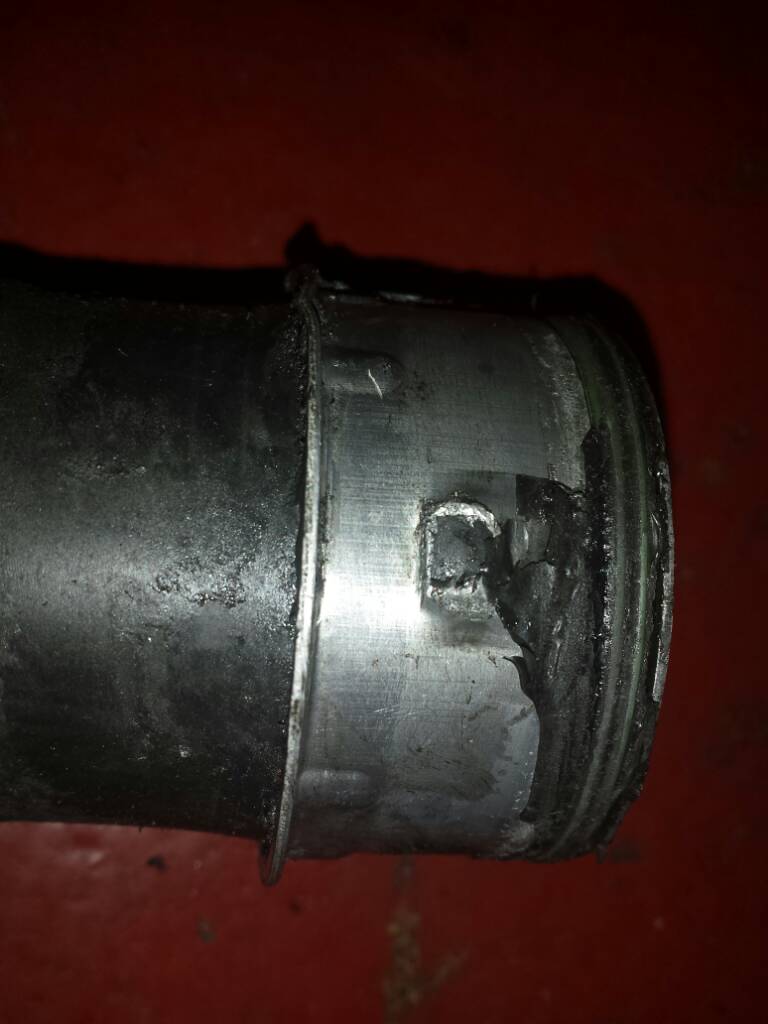

i think i have found the reason my economy hasnt been that great when driving. The pipe from the turbo-intercooler seems to be leaking where the metal pipe joins rubber pipe and you can actually here it
are these pipes expensive? or do i just need to replace the gaskets and clips if so any part numbers for these bearing in mind i have a seat ibiza fr 1.9tdi 130bhp
Yes but not quite as expensive as the OEM ones. SFS do a complete bottom pipe replacement - I think, and Forge do a replacement for the 90 degree bend off the turbo.
If it's leaking, check it's not simply the seals on the joints. Though that bend off the turbo has been known to fray/leak.
Do you have part number for the seals? Should I also replace c clips? Or should I simply use zip ties to create a cage and use instant gasket to create a seal?
why don't you phone TPS and then the main dealer and cross reference prices. for TPS say it's for trade. (yourself)
I did £130 all in for pipe from turbo two seals and two clips. The seals and clips are for the intercooler end of the same pipe work.
Ordered it as the pipe from turbo is rattling where the seal has worn down and the seal on that isn't available. Also the other end of that same pipe the lugs where the c clips grab on to are worn causing a fairly big airy noise boost leak. Hopefully be sorted Saturday. Probably going to do oil change as well just a a caution as it's car has been like this since I bought it.
That price for turbo boost pipe, 2x c clips and two seals was from tps with trade price.
This was the pipe causing problems both ends worn. Hopefully this sorts out my mpg issue.

i changed mine as the connecting lugs were shot and i managed to limp to TPS on my birthday and shell out £104 for new 90 degree pipe and new clips and also rubber gloves not to get dirty, so working on my birthday back in april and pipe blowing off every 2 miles, so glad i fixed it. :thumbup:
