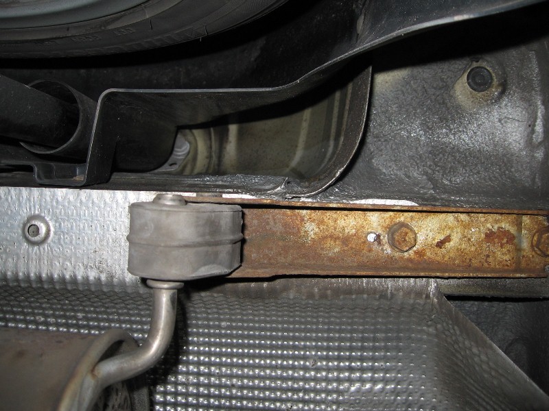

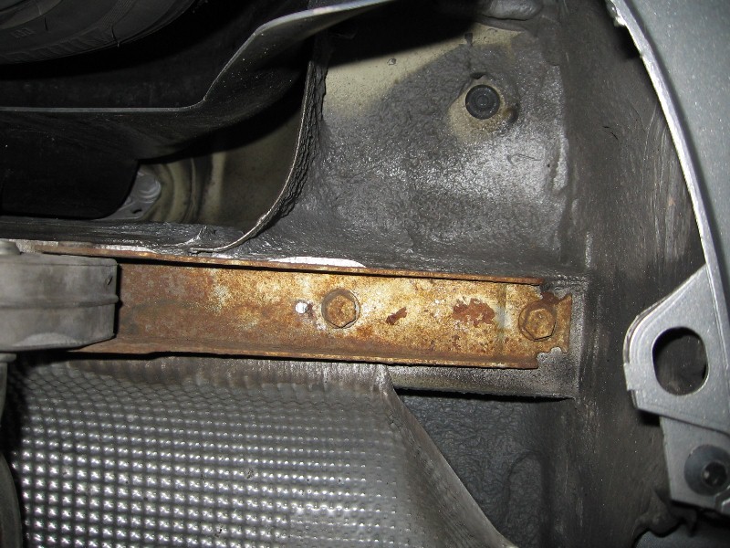

If you thought that those rusty drums on your new Fabia was bad (and it is) then try looking underneath...
These photos of my 4 year old (25k miles) Fabia 2, rear silencer hanging bracket.
I first noticed it was badly rusted at 2 years old, so I cleaned it up as best I could (in situ) and sprayed it with some hammerite, followed later IIRC with some protection wax thinking that would protect it
What a waste of time hammerite spray is. I've used it on my other cars and its rust prevention quality is more or less nil.
Why an unplated, unprimed mild steel bracket on a modern car? I shoould have complained in warranty, but I expect they will say "they're all like that sir"
Not the point i know, but that part looks pretty easy to take off & get powder coated somewhere.
We shouldnt have to but since you're out of warranty it'll prevent buying the new part in a couple of years, then another 1 a few years after that.
I know its not good but it does to appear to be only surface rust
My own 4 year old 1.6 16v Tiptronic estate is faultless underneath, except the rear silencer bracket is slightly rusty. As with rear drums, it's largely normal and harmless.  It's surface rust only. It cannot lead to anything bad even if you leave it. the contact metal underneath the bracket is covered in Cathodic primer which won't let it rust. My car lived it's first 3 years directly next to the beach on the south coast being covered in salt spray and driving on well salted roads (from the sea) everyday. It lived outside. There isn't one bit of rust anywhere on the car underneath, or anywhere else for that matter, except on that bracket same as yours. I cleaned it and coated it with Waxoyl black underbody wax just for something to do that day when had it over the pit in my garage. I used the thick black stuff. Don't paint it before you wax it and it'll then be fine. It would take decades to rust significantly even if left untreated. If you look under any car that's a couple of years old it will have rusty brackets and even the exhaust system will have some rust somewhere on it. II've even worked on Honda's and Nissans with rust forming on the underbody seams at 18 months old. Sadly, it's normal but not an issue in my honest opinion.
