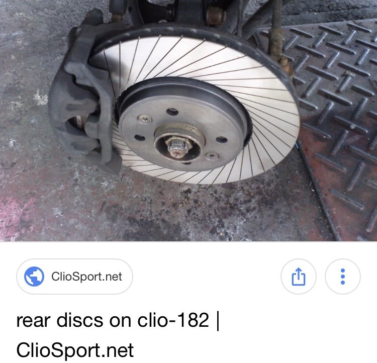

One of mine broke off at around 140,000 miles, so after a bit of research I found a lot of cars don’t actually have them, (mainly sporty cars) so I took the risk of removing the remaining bit and completely removed the other side. Now on 165,000 (+) and had no problems what so ever even with same discs.
Thought I might have scoring marks from grit etc or extra braking noise but nope nothing.
Just a little heads up if your thinking about completely removing them.
Example of clio cup ... (yes completely different car I know... I know ...
